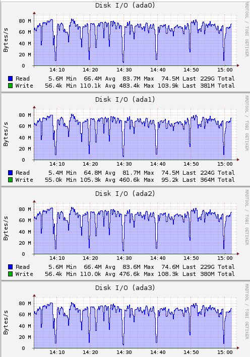

So, I just completed the scrub in 5:15h (with an average read rate above 225MB/sec). I attached a screenshot, the system is working better than ever.
I must admit, I didn't think, deduplication could be such a bitch. But that indeed was it!
Thanks all for your advice.

Dedup is something that can get out of control rapidly, which is why the harsh warnings are included and everyone will add you to an ignore list the second you mention you use dedup.
"Everyone"? What am I, chopped liver?
Dedup is like juggling chainsaws - it's incredibly awesome and wows people when you pull it off, but do it without a lot of prior research and planning, and you're going to have an incredibly messy death. Basically, unless you're running VMware View linked clones, don't.
@Blues Guy Glad I could help you get this sorted. You can always throw a "zfs get all | grep dedup" into a shell prompt to see if there's any other ones lingering, or if you have it set as a default somewhere that would cause inheritance down the line.
