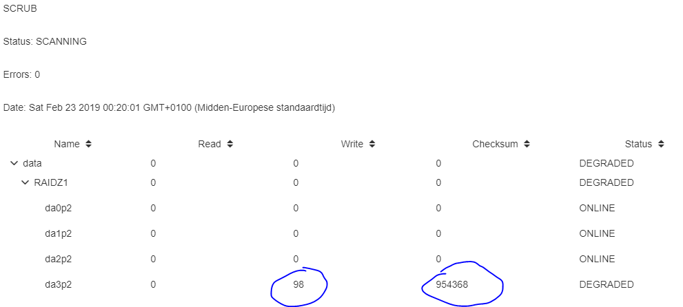

SOLVED Pool degraded, one drive dropped and reappeared again and error during bi-weekly scrub
Chris Moore
May 2, 2015
10,079
So far I replaced the drive and replaced the power cable. Should I be looking at a possible failure of the datacable or PSU?
It can be a bad data cable, but that usually gives CRC errors.
Can I detach that drive from the HBA and plug it directly into one of the SATA ports of the motherboard?
Yes, you can plug it to a different port and it would be a good test.
That should still work for the pool right?
Yes, ZFS is looking at the gptid, not the da#, so it doesn't care where the drive is connected as long as it is reachable.
If the problem goes away then it should either be the data cable or HBA.
Yes, it there are no errors when the drive is connected with a different cable to a different port, then it is either the cable or the HBA. I have heard of an HBA having a bad port before, but it doesn't happen often. You could test it by connecting the cable to the other port on the HBA.

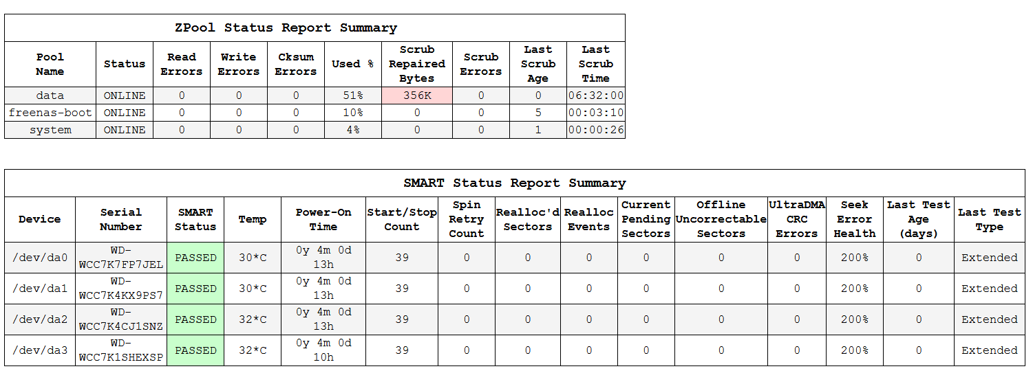

What are those errors exactly then I've experienced last night the "Checksum" and "Write" errors. Does this mean some of my data is corrupted now, did the scrub take care of that?
Edit
The pool is healthy again, I'm going to do another scrub to see if it finished without problems.
I'm also going to order a two new SAS to SATA breakout cables and a five SATA cables.

I am getting write and checksum errors again but on a different drive (different cable) but the pool didn't became degraded like it did earlier this week during a scrub, it still shows as healthy. Is there any conclusion I can draw from this? Could the current scrub be restoring a fault from earlier?
