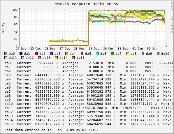

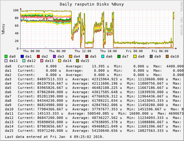

Exhibit one: disk bandwidth.
devilator_rasputin_gauge_volatile_diskbw_((ada|da|ad|mfid|aacd|amrd|nvd)|d+)_busypct-weekly.png
Despite the long time, on Jan 3rd it had completed less than 20% of the scrub. Looking at other ZFS stats I noticed stress on the l2arc. There were increased writes and l2arc misses.

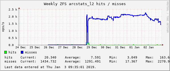

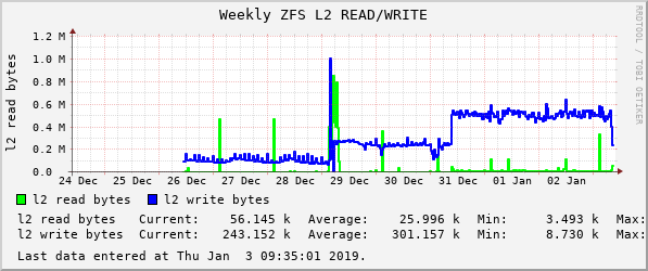

devilator_rasputin_counter_zfs_arcstats_l2_read_bytes,__zfs_arcstats_l2_write_bytes-weekly.png
Suspecting something fishy with the scrub prefetches I tried disabling scrub prefetch. And the effect couldn't be more dramatic. Setting the vfs.zfs.no_scrub_prefetch to 1 the scrub begun progressing healthily. The busy percent of the disks went down and performance improved as well.
devilator_rasputin_gauge_volatile_diskbw_((ada|da|ad|mfid|aacd|amrd|nvd)|d+)_busypct-daily.png
The busy% went from almost 100 to 40% when I disable the scrub prefetch. At the same time the scrub begun progressing normally and it actually finished in about three hours. The two peaks after around 13:30 are another scrub I started with scrub prefetch disabled. As you can see it worked normally.

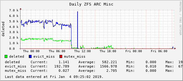

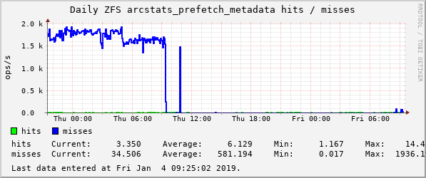

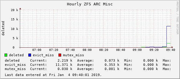

Other stats show that the l2arc was really relieved when I disabled scrub prefetch.
devilator_rasputin_counter_zfs_arcstats_deleted,__zfs_arcstats_evict_skip,__zfs_arcstats_mutex...png
devilator_rasputin_counter_zfs_arcstats_prefetch_metadata_hits,__zfs_arcstats_prefetch_metadat...png

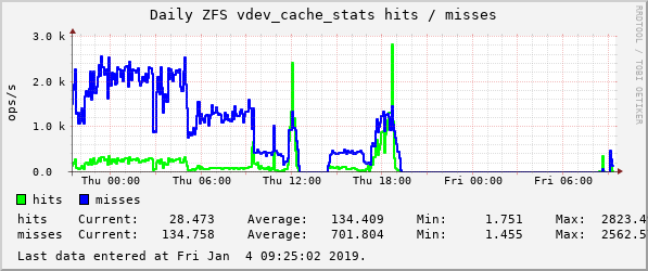

And the prefetch also hurt the vdev cache. It behaved much better during the second scrub with prefetch disabled.
devilator_rasputin_counter_zfs_vdev_cache_stats_hits,__zfs_vdev_cache_stats_misses-daily.png

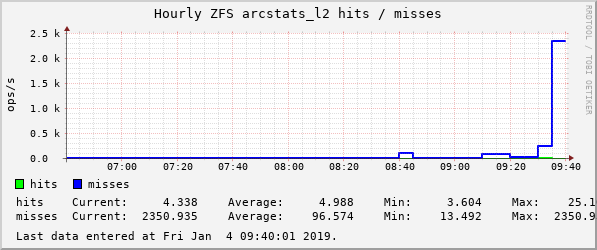

I have started another scrub today with scrub prefetch enabled but using the legacy scrub code and it has stalled again. Looking at the cache stats I see
that it's suffering as well. I include just a couple of graphs.

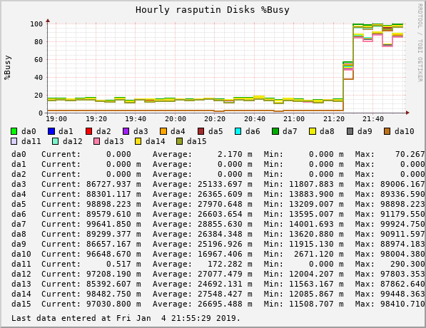

Seems to be stuck again, this time there's no SSD.
# zpool status
  pool: pool
 state: ONLINE
  scan: scrub in progress since Fri Jan  4 21:27:53 2019
    26.5G scanned at 14.9M/s, 120M issued at 67.4K/s, 539G total
    0 repaired, 0.02% done, no estimated completion time
Half an hour since it begun and it's stuck at 26.5 GB while the disk busy percent is around 100%.
devilator_rasputin_gauge_volatile_diskbw_((ada|da|ad|mfid|aacd|amrd|nvd)|d+)_busypct-hourly.png
