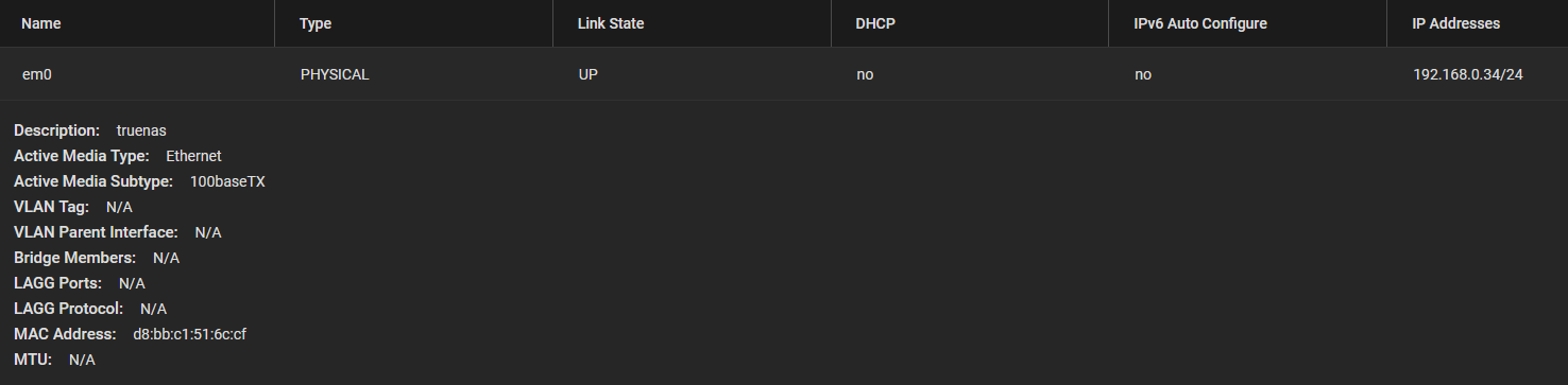

Hello now i am getting this error not sure how to solve it
not sure if it important my main isp router ip is (192.168.1.1)
while the actually router ip that ALL devices in my network use is 192.168.0.1
[ /mnt/tank/nextcloud/themes '=' /mnt/tank/nextcloud ]
+ echo 192.168.0.190
+ cut -f1 -d/
+ IP=192.168.0.190
+ cut -f2 -d/
+ NETMASK=192.168.0.190
+ [ 192.168.0.190 '=' 192.168.0.190 ]
+ NETMASK=24
+ [ 24 -lt 8 ]
+ [ 24 -gt 30 ]
+ ls -A /mnt/tank/nextcloud/config
+ cat
+ iocage create --name nextcloud -p /tmp/pkg.json -r 13.2-RELEASE 'interfaces=vnet0:bridge0' 'ip4_addr=em0|192.168.0.190/24' 'defaultrouter=192.168.0.1' 'boot=on' 'host_hostname=nextcloud' 'vnet=on'
nextcloud successfully created!
Stopped nextcloud due to VNET failure
+ echo 'Failed to create jail
+ exit 1
Command exit status: 1
and this i my config file:
JAIL_IP="192.168.0.190"
DEFAULT_GW_IP="192.168.0.1"
INTERFACE="em0"
POOL_PATH="/mnt/tank/nextcloud"
TIME_ZONE="Asia/Riyadh"
HOST_NAME="truenas.XXXX.com"
STANDALONE_CERT=1
CERT_EMAIL="pm@xxxx.com
COUNTRY_CODE="SA"
DB_PATH=" /mnt/tank/nextcloud/db"
FILES_PATH=" /mnt/tank/nextcloud/files"
CONFIG_PATH=" /mnt/tank/nextcloud/config"
THEMES_PATH=" /mnt/tank/nextcloud/themes"

You have 192.168.0.1 as your gateway in your config file, but you state above that you router (gateway) is 192.168.1.1
Is your subnet larger that /24?

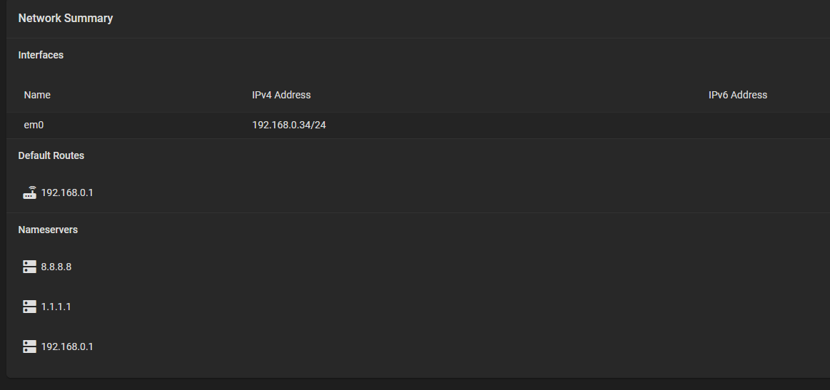

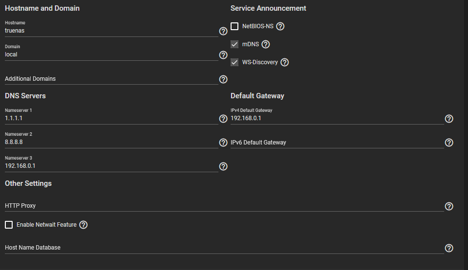

I have 2 routers one form my isp that is crappy and basically use to convert fiber to ethenert (192.168.1.1) and my second router(192.168.0.1) with port forward from to use and works as i openvpn works
as for my subnet, how don't the only thing i found to subnet is this in my gateway (255.255.255.0)

Your issue is likely the INTERFACE variable. Remove it from your config file.

so it started istalling then failed, then did it 3 more times before come with an error
Installing pkg...
pkg failed to install, retry #1
pkg failed to install, retry #2
pkg failed to install, retry #3
pkg error:
- pkg-static: http://pkg.freebsd.org/FreeBSD:13:amd64/quarterly/meta.txz: No address record
pkg-static: http://pkg.freebsd.org/FreeBSD:13:amd64/quarterly/packagesite.pkg: No address record
pkg-static: http://pkg.freebsd.org/FreeBSD:13:amd64/quarterly/packagesite.txz: No address record
Please check your network
+ echo ' Failed to create jail '
+exit 1
this is the full log if it isn't enough(edited of course to hid any sentetive data):

gateway:yes
nameserver was set to:
1.1.1.1
8.8.8.8
will add the 192.168.0.1 to nameserver3 and will test again

Well no luck saw error here are a few picture that may help
current config file:
JAIL_IP=”192.168.0.190”
POOL_PATH="/mnt/tank"
HOST_NAME=”truenas.XXXXXXXX.com”
STANDALONE_CERT=1
CERT_EMAIL=pm@xxxx.com
COUNTRY_CODE=”SA”

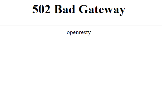

Hello, I recently installed nginx proxy manager, now I cannot access nextcloud... If I portforward on the router directly to nextcloud ip is ok and it is certified, but through the proxy manager I get a 502...
Does anyone know what is the solution?
victort
Dec 31, 2021
973

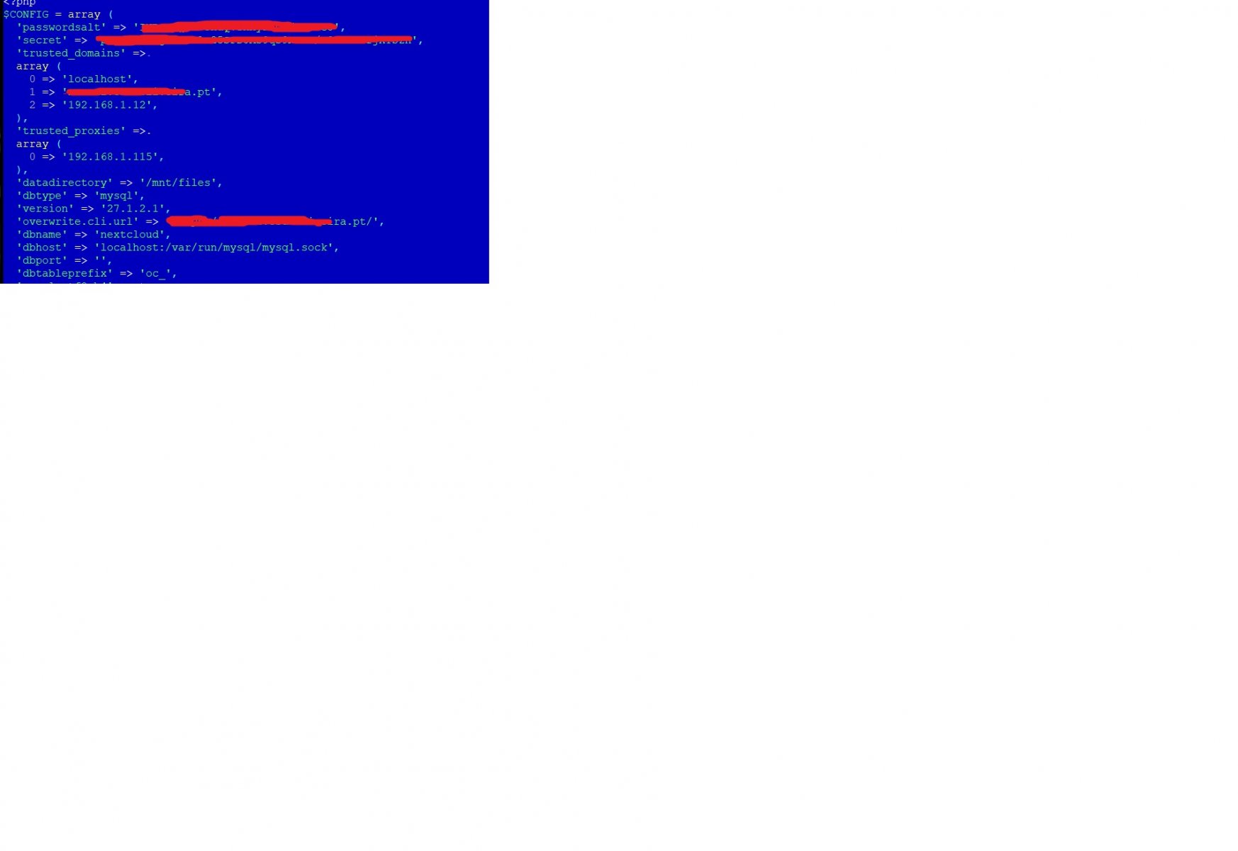

Are you using the same domain name?
You need to add your Nginx IP to Nextcloud trusted proxies.
tassevem
Oct 14, 2023
13
Yes, everything is the same. I just added nginx because I need to be able to connect to more systems from outside of my network. If I point my port forwarding in the home router straight to the local IP it works great. I think it must be some caddy configuration.
victort
Dec 31, 2021
973

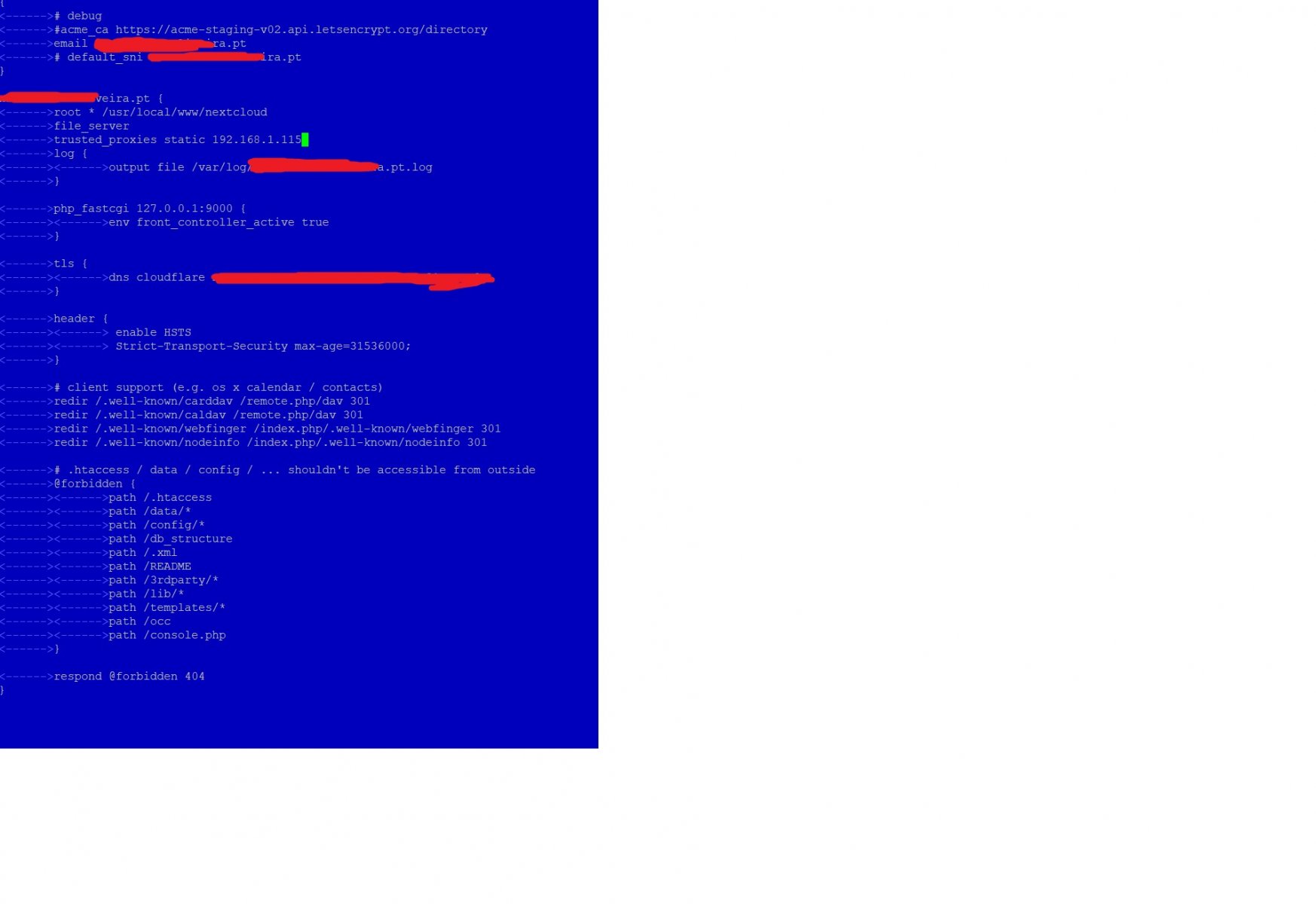

Did you add the Nginx IP to Nextcloud trusted proxies?
Also, in the global block of the caddy instance serving your Nextcloud install, you need to add your Nginx as a trusted proxy as well. See https://caddyserver.com/docs/caddyfile/options
The global block would look like this
  servers {
    trusted_proxies static 192.168.x.x
tassevem
Oct 14, 2023
13
Still no good...
