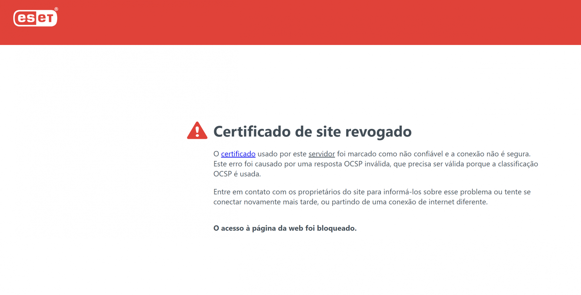

tassevem
Oct 14, 2023
13
I have my house ip in my dns, and in my regular vodafone router, have port forwarded.
I changed the configuration. Deleted the 4 folders and created 4 datasets. It is diferent, but still not working.
Now it is giving a certificate error.
I dont know if it is because my main install has a valid certificate, should I execute the "iocage exec nextcloud /root/remove-staging.sh" comand?

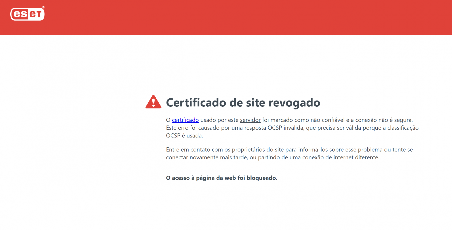

tassevem
Oct 14, 2023
13
It was the Anti-virus blocking because it did not trusted the certificate.
But now I cannot install the certificate.........................................
Can anyone provide a solution?
victort Thank you for being so helpful.
