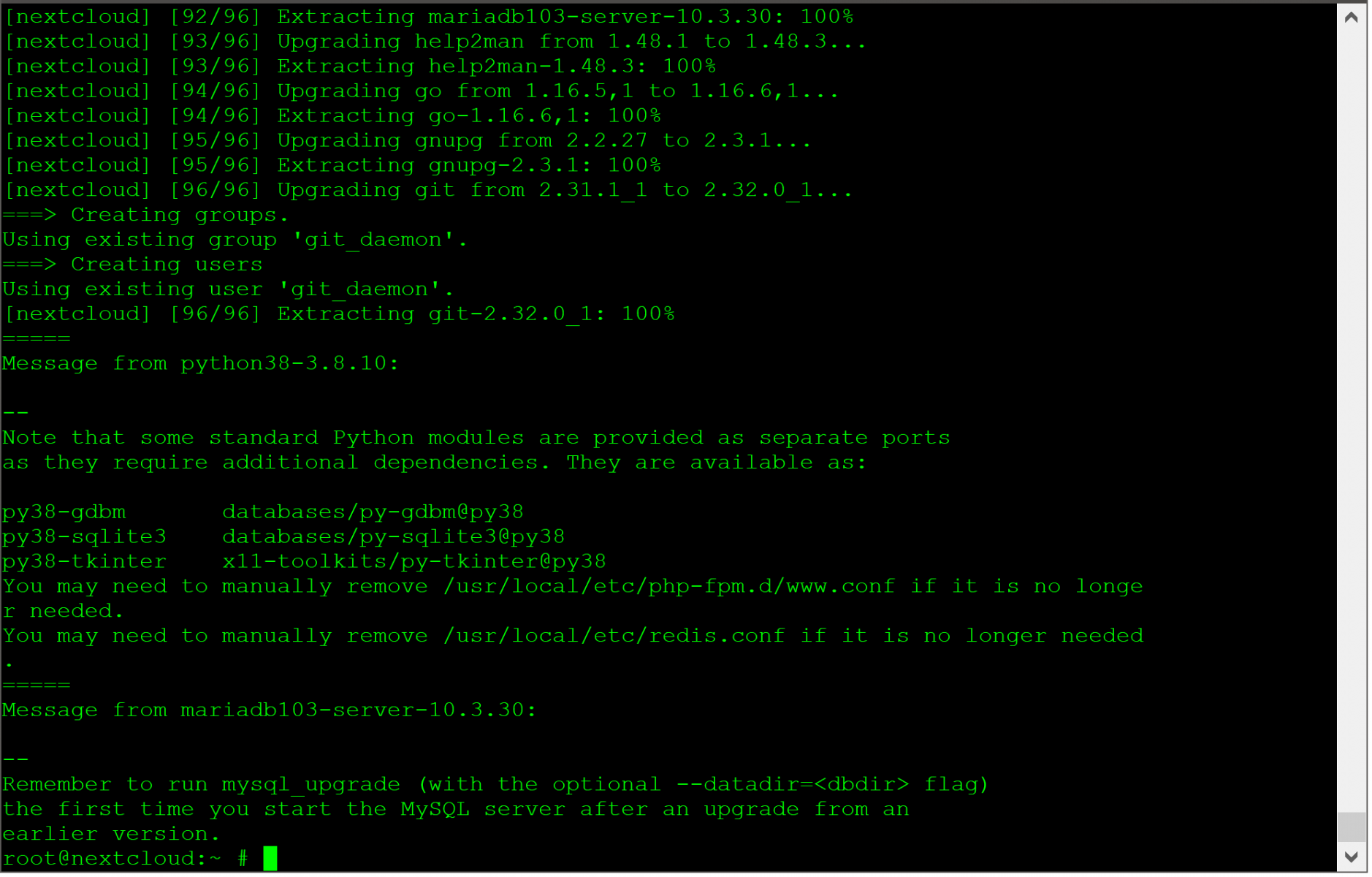

I have run into issue when I update the nextcloud jail through the web UI and after that every broke. Since I could not access using the internal IP address. I cannot do anything or figure out what's wrong. I did try to store from the snapshot before the update and everything works fine now. So my question is, what would be the best way to update?
Update on the command line. Be aware that there may be additional steps if e.g. MySQL/MariaDB gets an update. Info about that can be found in the MySQL/MariaDB docs. And definitely after every Nextcloud update you need to run the occ tool to upgrade your database. All about that can be found in the Nextcloud documentation.
I believed I might have successfully upgrade the jail using the command line and be low is the picture I got after the upgrade. What step or command to I need to run for MySQL/MariaDB? and how do I run the nextcloud OCC command and what is that OCC for?
It says right in your screenshot to run mysql_upgrade.
Log in to your jail and become root - either direct ssh or iocage console as you prefer. Type mysql_upgrade -p. Enter the root password of the database server. Watch for error messages. If there are none, all is good.
Then run - still as root: su -m www -c "/usr/local/bin/php /usr/local/www/nextcloud/occ upgrade".
Documentation for that can be found here:
Restart your jail. Done.
HTH,
Patrick

Work like a charm. Thank you so much!
