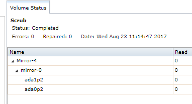

I reversed the order of the scrubs on my 4 mirrors & it is the last (4th) one chosen that doesn't run even though the GUI said the 4th scrub had started (see attached file) which shows scrub had completed but the run time of the scrub was only a few seconds

Is the amount of data stored on Mirror-4 small? If so it's not surprising that a scrub takes not much time.

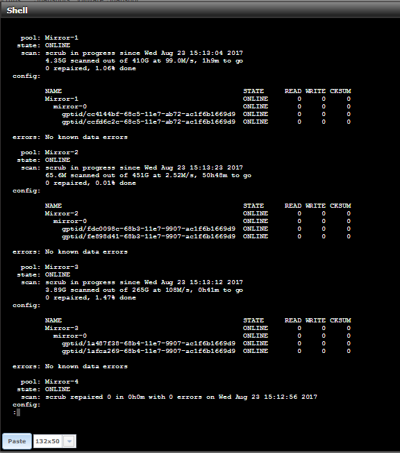

This is a shell print after starting a 4 mirror scrub. As can be seen the last (Mirror-4) scrub hasn't started even though the GUI said it had!
Just missed your response.
Yes this could be the answer as I only have a small script folder on mirror-4. I'll copy a large file to mirror-4 & restart the scrub while the other 3 scrubs are still running

I have a small SSD pool in my system besides two HDD pools and this is what zpool status -v tells me (there is no evidence that the scrub on Tue Aug 15 did not run, it just takes almost no time):

Just copied a 9GB file to mirror-4 & ran a scrub as detailed in last post & can confirm that all 4 scrubs ran simultaneously (although the mirror-4 scrub didn't run for long due to the relatively small mirror size.
Good suggestion MrToddsFriends & thanks:)
