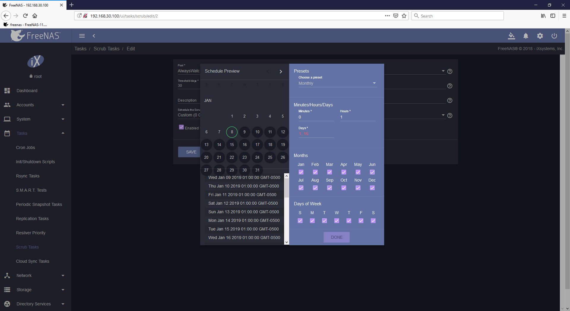

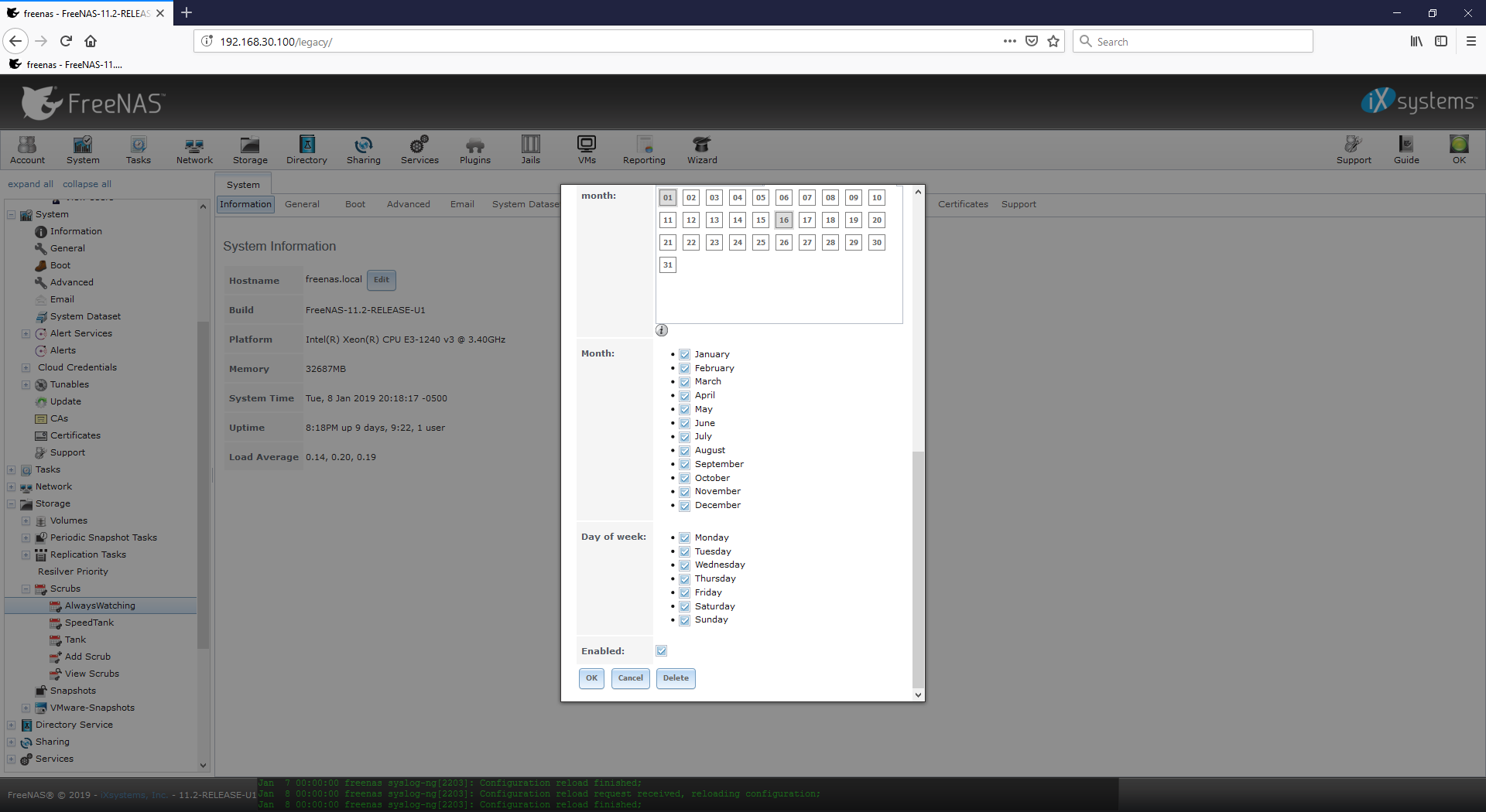

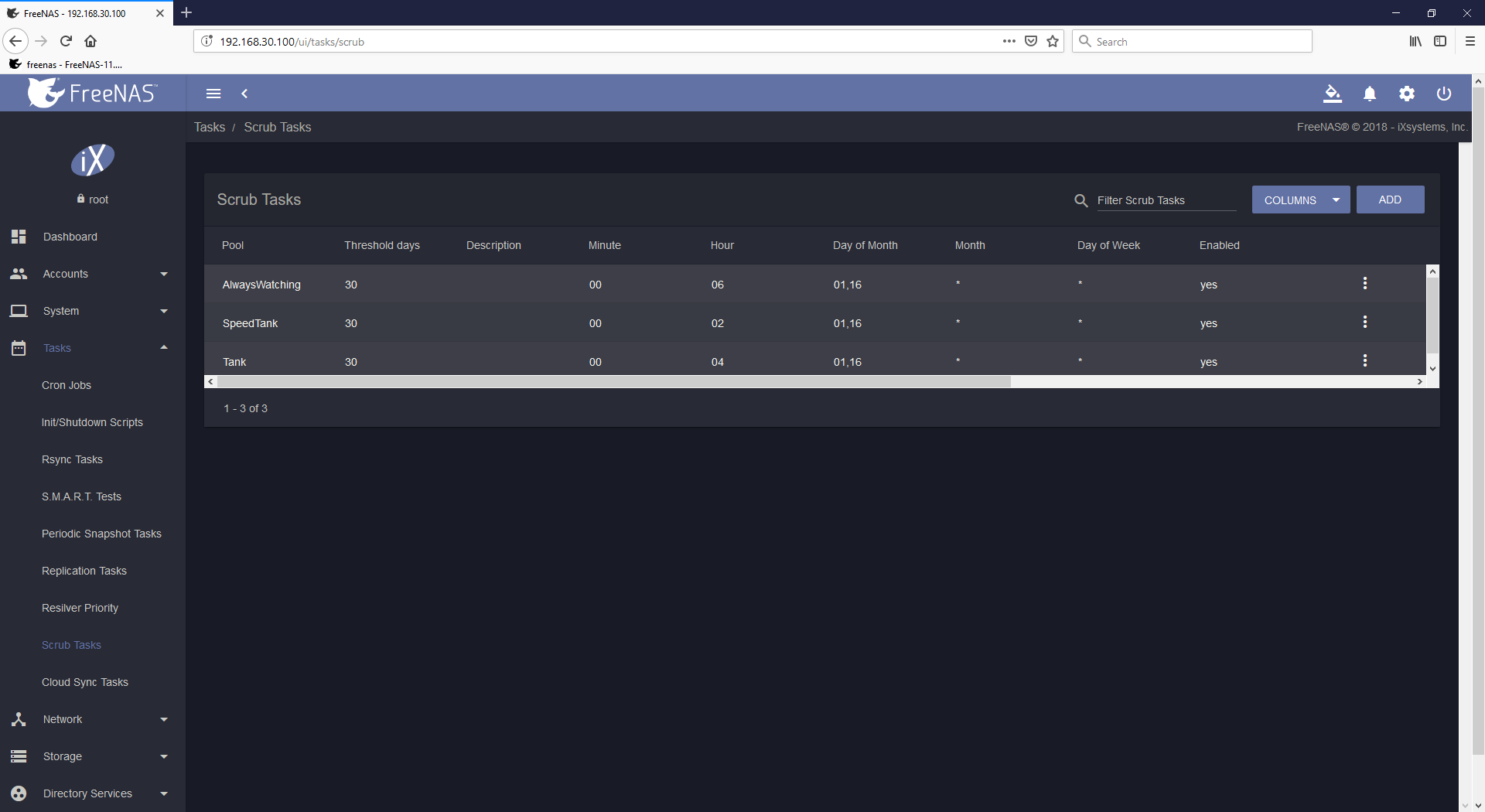

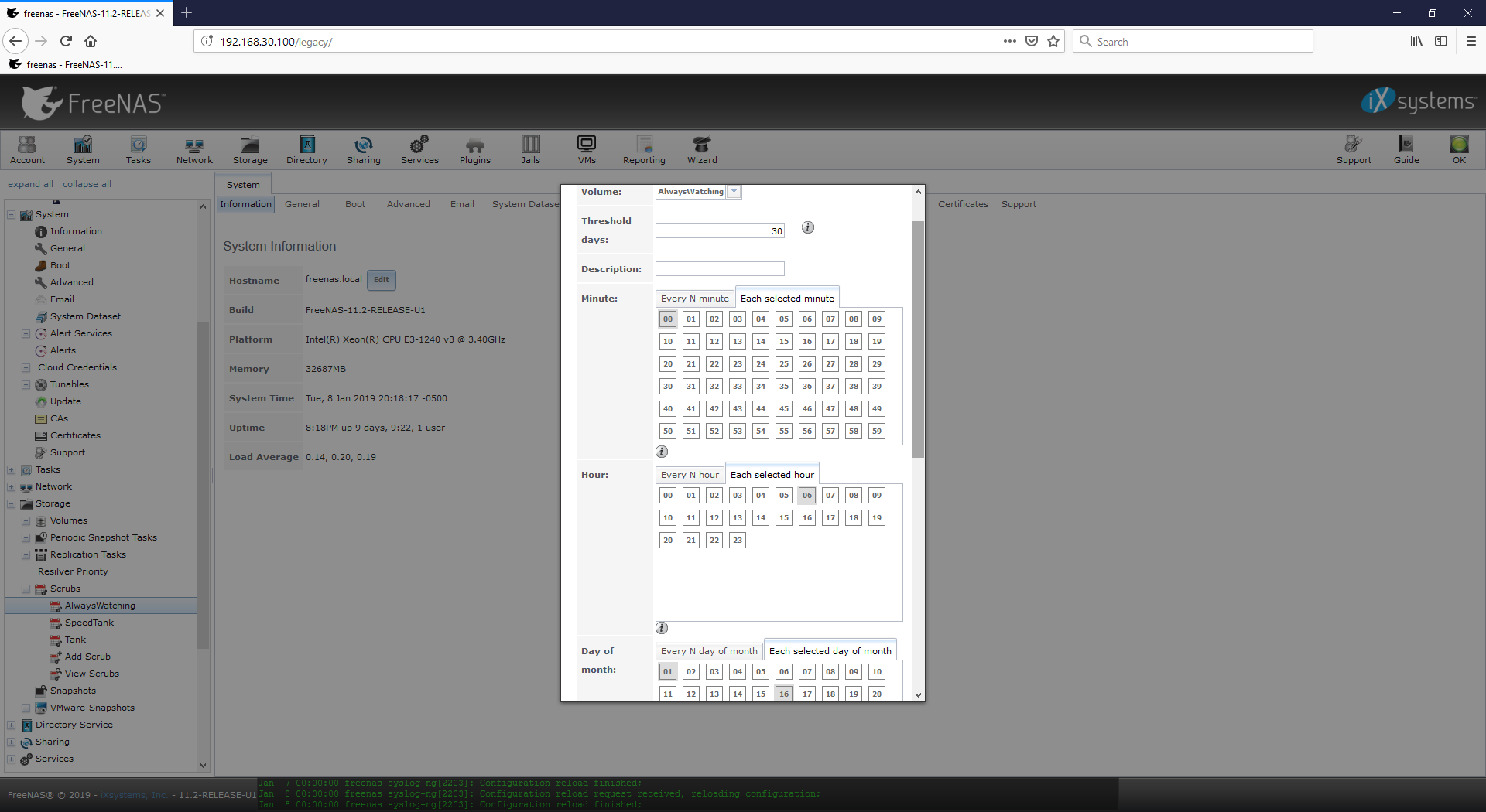

After the initial install I was struggling with some of the changes in the GUI so I moved back to the Legacy Interface to get things going. One thing I am finding I have a problem with is my scrubs. I scheduled them via the legacy GUI and thought all was well. I scheduled a scrub to run on the 1st and 16th each month at 0100, 0300 and 0600 for the respective pools. This is the same schedule I had prior to rebuilding minus the 1 additional pool which worked fine. Under 11.2 the scheduled scrubs don't seem to run (these were set-up via the legacy interface). After trying to change the schedule via the new GUI I find that trying to follow the same process for custom schedules (set dates and set times you want to occur, allowing to occur every month on any day of the week) that the scrubs seem to be scheduling for everyday of the week, for every month of the year for the specified times. Screenshots attached.
11.2-Scrub Schedule.png 11.2-Custom Scrub Schedule.png 11.2-Legacy Scrub 1.png 11.2-Legacy Scrub 2.png
