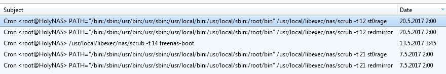

As you can see there is something more behind as scrubs for both of my pools were executed today (Saturday) even the schedule is set to Monday/Tuesday

But something else is executing the scrubs. Hell i am even receiving emails about that at a wrong days!
starting scrub of pool 'st0rage'
starting scrub of pool 'redmirror'
Am i drunk or my NAS is ?

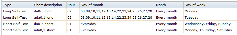

This definitely needs a better interface in the new GUI. That said...
It DOES NOT mean that this script will run at 11:10 at 15th, 16th, 17th and only if it's Saturday
What it actually means is that the script will run at 11:10 three days in a row (15th, 16th, 17th) AND any kind of saturday no matter what day of the month it is !!
My experience is the opposite. I have all weekdays checked and yet the scrub always runs on the 8th and on the 24th of each month.

Currently i have:
Which is again wrong due to the day-of-week vs day-of-month thing. But where i can find this?

One more thing regarding the SMART tests ... anyone knows where the schedule is actually stored? I have four SMART schedules but they're not in crontab
I guess i will get rid of these as well and make my own schedule as you suggested - at least for long tests to ensure that they will not hit the same window as the scrub ...
