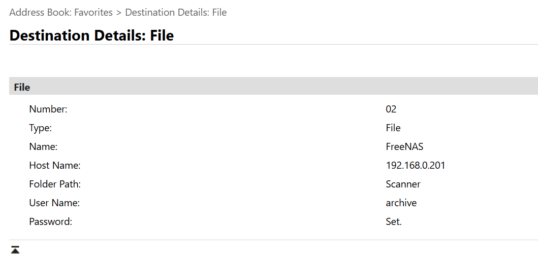

Scan Folder - Authentication Failed?
architect
May 5, 2020
11
I'm not that tech-savvy but trying to set up a scan folder on my TrueNAS for my new Canon imageCLASS MF455dw. In TrueNAS, SMB has both SMB1 and NTLMv1 ticked. I use the same SMB credentials that I access from my Windows PC, but I keep getting a login/authentication failure. Thoughts?

Easiest way to see parsible version is midclt call smb.status AUTH_LOG | jq
Not sure why the user name has an @ at the end here when I did not include this in settings:

      "remoteAddress": "ipv4:192.168.0.100:64301",
      "serviceDescription": "SMB2",
      "authDescription": null,
      "clientDomain": "",
      "clientAccount": "archive@",
      "workstation": "CANON1FCC8C",
      "becameAccount": null,
      "becameDomain": null,
      "becameSid": null,
      "mappedAccount": "archive@",
      "mappedDomain": "",
      "netlogonComputer": null,
      "netlogonTrustAccount": null,
      "netlogonNegotiateFlags": "0x00000000",
      "netlogonSecureChannelType": 0,
      "netlogonTrustAccountSid": null,
      "passwordType": "NTLMv2",
      "duration": 103564
    "timestamp_tval": {
      "tv_sec": 1672292097,
      "tv_usec": 752321
    "timestamp": "2022-12-29T00:34:57.886292-0500",
    "type": "Authentication",
    "Authentication": {
      "version": {
        "major": 1,
        "minor": 2
      "eventId": 4625,
      "logonId": "0",
      "logonType": 3,
      "status": "NT_STATUS_NO_SUCH_USER",
      "localAddress": "ipv4:192.168.0.201:445",
      "remoteAddress": "ipv4:192.168.0.100:64306",
      "clientDomain": "",
      "becameSid": null,
      "mappedDomain": "",
      "passwordType": "NTLMv1",
      "duration": 104994
