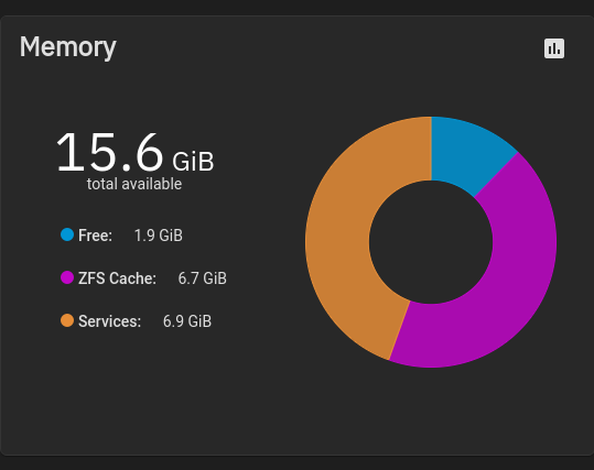

I'm running into the same issue here, however I only have 1 service currently running Plex through Apps. My memory allocation looks very similar to OP... Is this something to be expected? I though that I would have enough RAM to do at least a couple of things at once...

When you say whatever RAM is left over.... How exactly is that calculated?
You have 6.7GB allocated to ZFS... if you add more services, that ZFS RAM will shrink. If it gets too low, performance will reduce, but you will see that.

Thanks for the quick reply! Really appreciate the explanation.

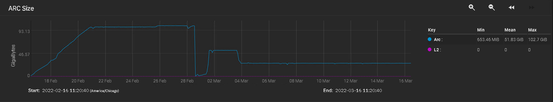

I have to disagree only due to observation. I have a system with 128GB RAM, with a couple of VMs running, and my ZFS Cache ranges from 20GB to 100GB, with it changing on the fly. I have between 55GB and 10GB free RAM at all times, so ZFS isn't taking all available RAM under SCALE, it seems to be dynamic based on some algorithm that is in flux.
Here's the point-in-time, and below, you can see where the ARC grew while I was moving a lot of data over, then it went down around 28-Feb due to a reboot, but since then the system hasn't been rebooted and you can see the ARC grow, then reduce itself for some reason. I haven't removed any load from this NAS, it's been constant, so I don't know why SCALE reduced the ARC size. Since I don't have L2ARC, the tracking or ARC to ZFS Cache on the dashboard is 1:1.
So just based on observation, wither it's the port of OpenZFS to Debian, or some other difference, SCALE definitely dynamically adjusts the ARC up and down, and doesn't always use all available RAM. I personally like this, in a way, but would be interested to understand the algorithm behind it.
fair enough, that was an oversimplification. from our perspective, as users, ZFS RAM usage is intended to be transparent and automatic.
zfs will dynamically use whatever RAM is available to try and intelligently cache files that are accessed (ARC) and writes to pools (collected into transaction groups and flushed to disk in regular intervals, usually like 5 seconds, as contiguous writes when possible).
if you have enough RAM to cache everything that is accessed reasonably frequently, then it will not use all the RAM, but whatever is most useful. I believe this is what you're seeing.
if, however, you are pounding the server with enterprise usage, like a massive database or huge VM stores, then you would see different behavior with ZFS stretching it's algorithmic muscles to get the most reliable performance from what it was fed (hardware).
The algorithm in Linux/SCALE is more complex than FreeBSD
It will get more tuning now that we have got to the RELEASE stage.
That does explain the observation then, especially when comparing the other box not running SCALE using a fairly fixed amount of RAM all the time.
I do have to say my ARC hit rate is 99%, rarely dipping below that to 98%, so more than enough there. I wonder what the OP is seeing for hit/miss rate on their ARC. That's what I always understand to be the true indicator if more RAM is needed for ARC or if L2ARC is needed.
