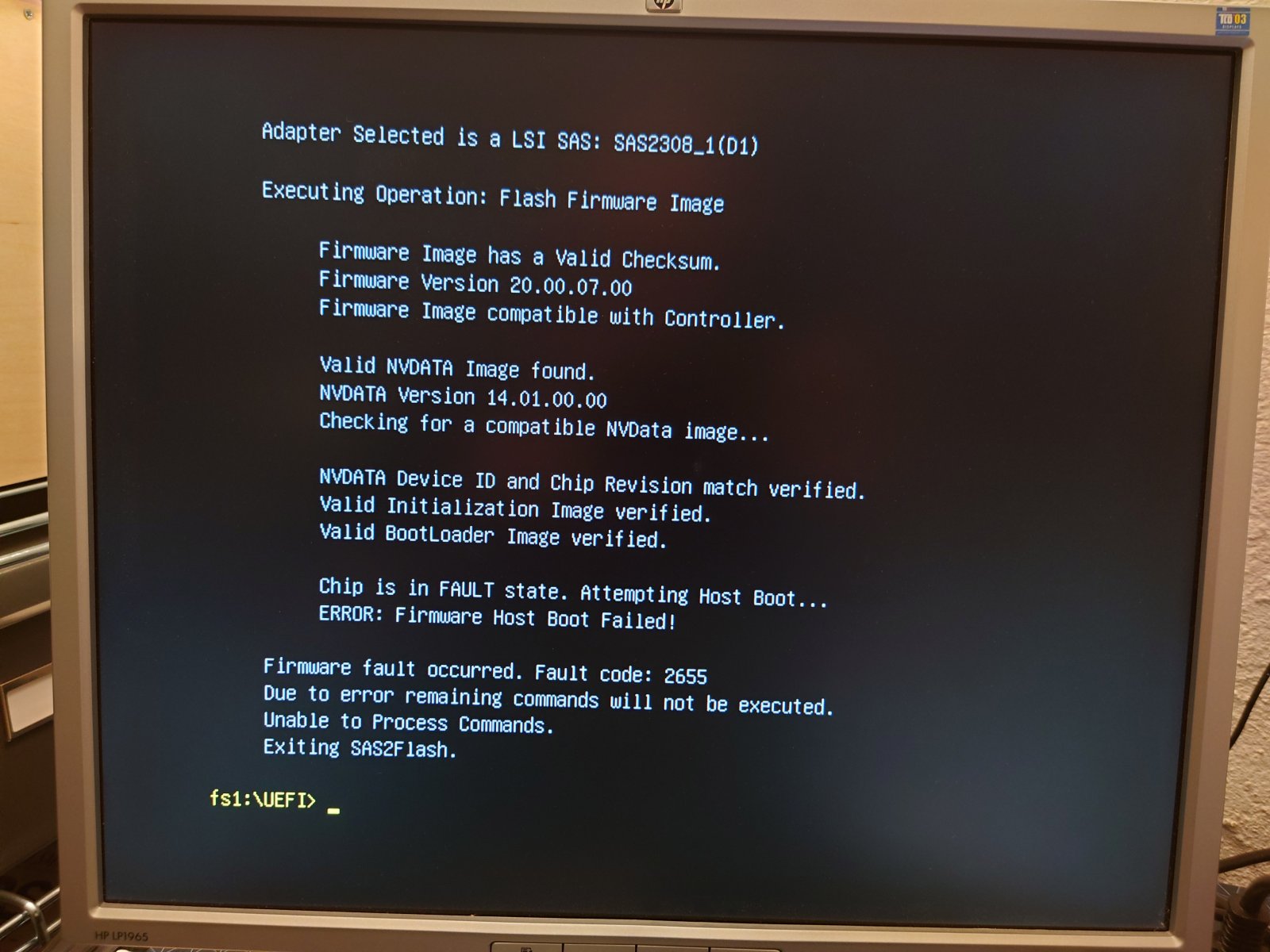

i have tried to read up on what to do and i have tested to re-flash the firmware to the controller with sas2flash in uefi shell but it doesnt work. it says that "chip is in fault state" and "firmware fault occurred. fault code: 2655". Good news is that it actually sees the chip. Are there any way to reset the chip?
i have tried to erase the firmware, flash new firmware (IT ver 20), disabled option boot in bios and tested re flashing but nothing worked.

thank you. i have seen that one and tested but no luck for me. only difference that i can see is that he is using fw 19 and im trying with fw 20. cant seem to find an older one to try with.
