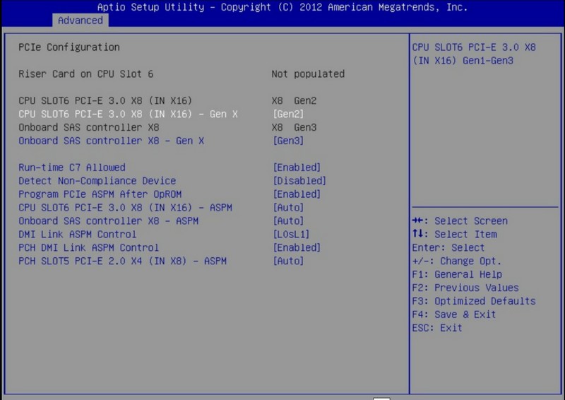

I own a system based on the same motherboard. Your problems may be due to BIOS settings: there are quite a few ways to configure the PCI-E slots -- the 'Generation' in particular -- and it may be that you need to tweak these settings to fix your problem:
