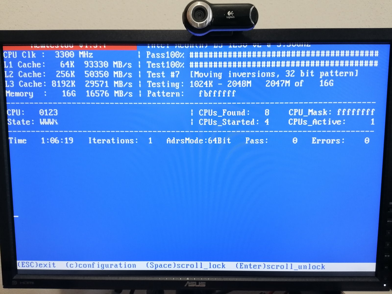

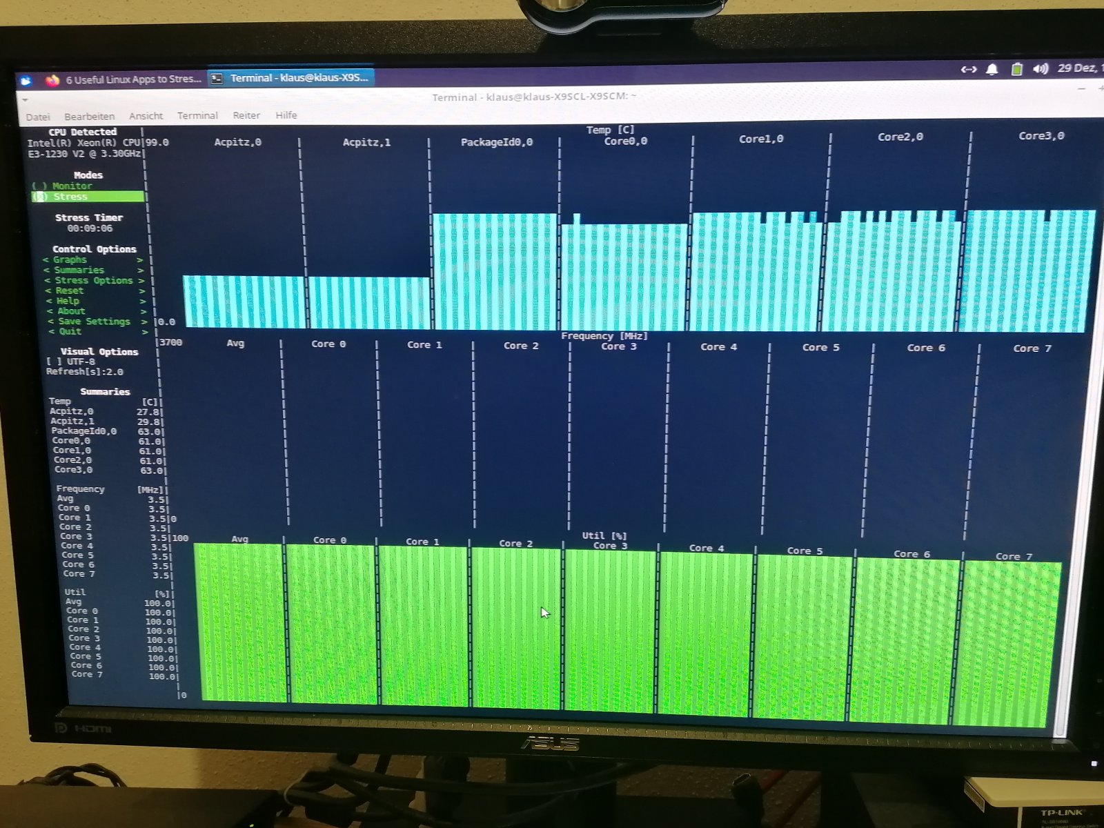

After that I made some tests to the equipment:
A) memtest86 (I'm not sure if this makes sense with ECC RAM but I wanted to be sure) - no problems reported
B) CPU burn for approx 1h (I installed ubuntu before) - no crash / freeze

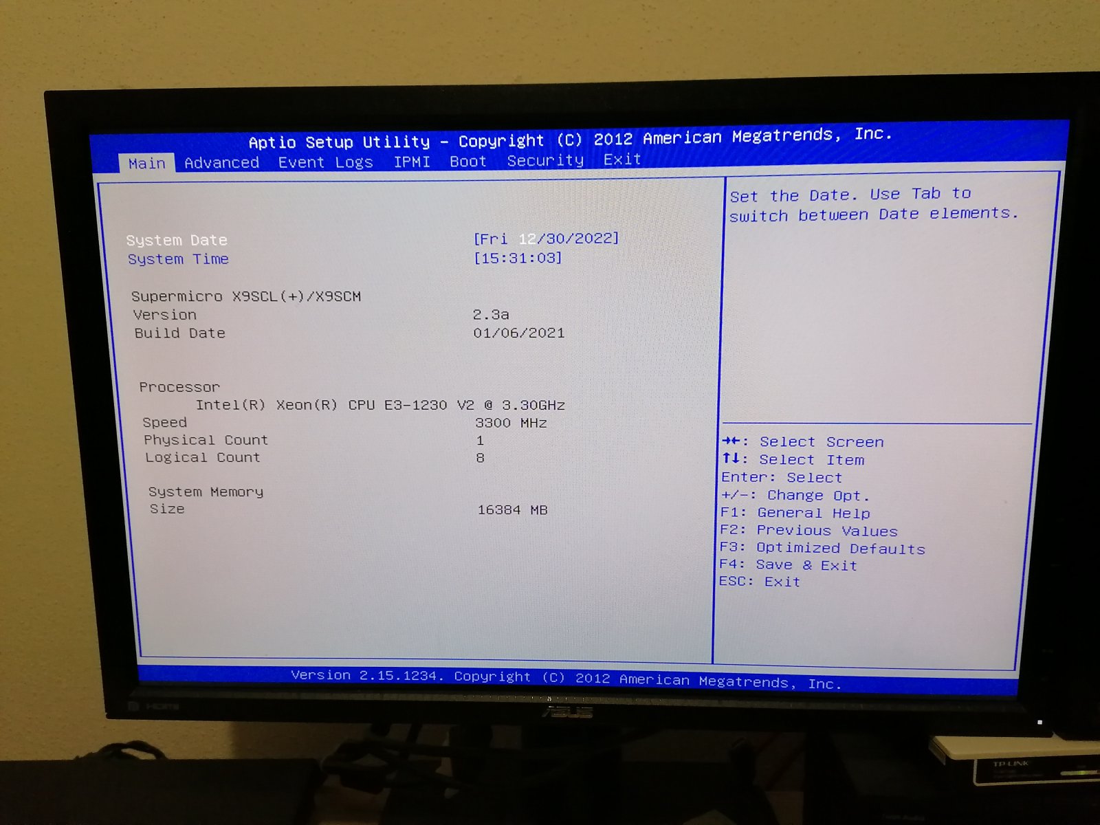

Mainboard BIOS Build: 2.3a (01.06.2021)
