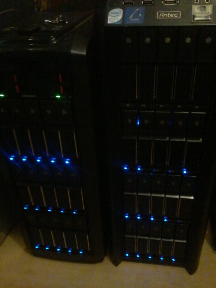

CraigD
Mar 8, 2016
343
You could try building one yourself, by putting multiple IcyDock 3.5"-into-5.25" cages into an ATX case, doing internal wiring using SFF-8087 breakout cables, and finally an SFF-8087 to SFF-8088 bracket in the back to connect to an HBA - but again, that seems like it will add up in cost quickly.
This is my recommendation
It is not that hard my JBOD can hold 20 drives, I was using cheap cages but now use Kingwin 5 drive enclosures, a SAS Expander, a PCIe riser, and a PSU jumper, PSU, a large case, 8087 to 8088 pass thru, an 8088 cable, and a reverse breakout cable (you can use a 8087 cable from your SAS card) and some 8087 to sata cables
Have Fun
JBOD is on the right
