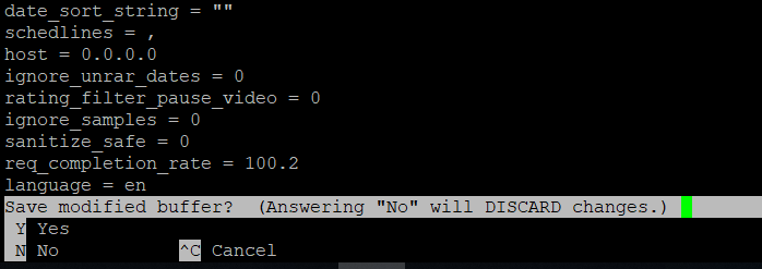

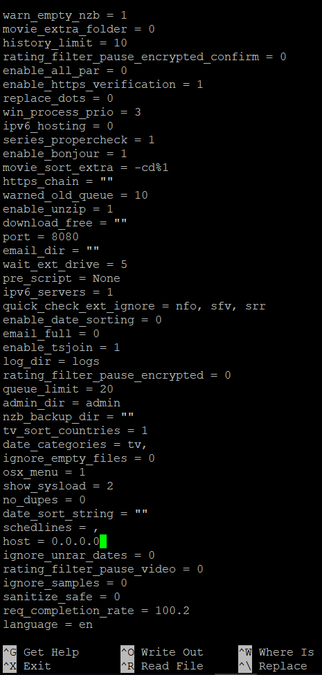

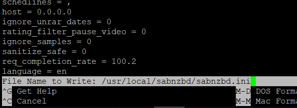

I have identified the problem in my first post; It was me :')
FreeNAS doesn't play well with Virtualbox, you need some very specific settings in Oracles VM.
It was causing some DNS hickups, which in turn made the repository unreachable.
Ive sorted this problem out now, and im in the process of installing sabnzbdplus manually as we speak.
Im hung up on the "Change the host line to host = 0.0.0.0" part simply because I cant find it in nano though. :oops:
Jul 10, 2018
25
I've sorted this problem out now, and im in the process of installing sabnzbdplus manually as we speak.
Im hung up on the "Change the host line to host = 0.0.0.0" part simply because I can't find it in nano though. :oops:
So when you get into the config file with nano just hit the down arrow until you get to the right line. It's in here and you have to go down quite a bit.
Type ctrl+shift+x
It will ask you if you want to save changes
Type Y
Now hit enter, and it will save the file. At this point you should be able to access sab through the browser by typing in the jail ip address:8080.
I hope this gets you there buddy.
