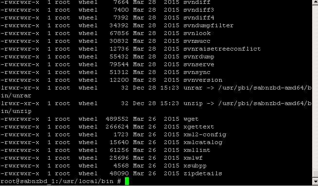

Josh just letting you know it was permission issues but I did install three seperate jails for the three but got it working. Now since I have everything downloading like it should and even moving/renaming when it can. I do run into an issue with SABNZBD saying it does not have a PAR2 program to unrar/unpack the files and I think it might be permission related. Should the files in /usr/local/bin be under the same user and group media:media or should it be under root?

I doubt the par2 issue is a permission issue. 99% of the time, binaries in bin should be owned by root. as long add the file has execute permissions any user can use the program.

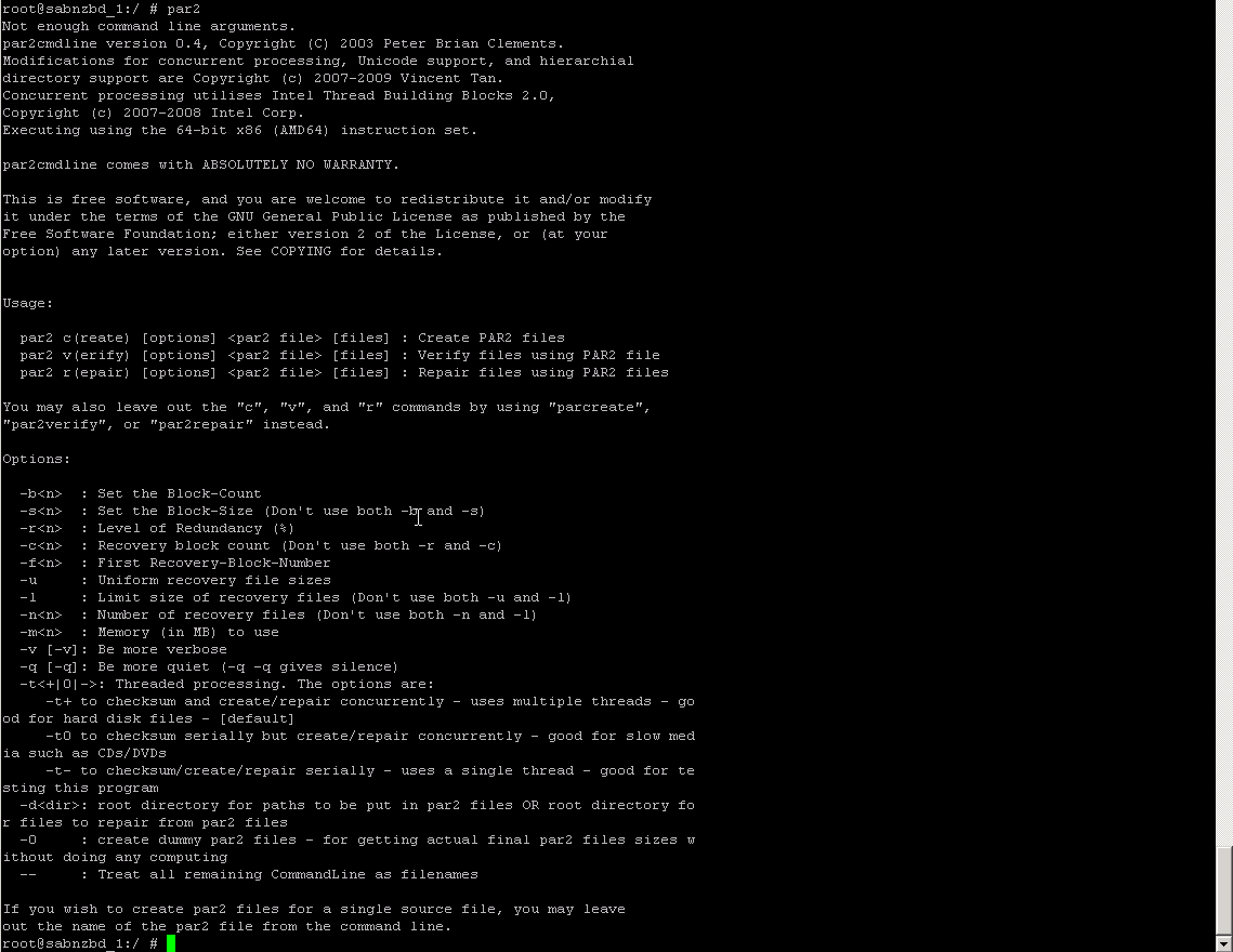

what output do you get when you run 'par2' in your jail? maybe some of the system linked binaries/libraries got deleted somehow.
other commands to try are 'ls -l /usr/local/bin | grep par2'

Here is the permissions on /usr/local/bin on the jail.
