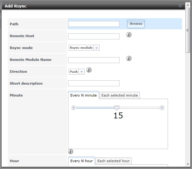

I'm thinking of using DeltaCopy to rsync "My Documents" from a Windows PC to a FreeNAS 8.2 box. It seems to me that the task should be pretty straightforward. Yet, I've looked through the docs and forums. I don't see a clear answer. :-\ Could someone help me quickly over this hurdle?
I could use Microsoft's SyncToy, but would prefer rsync. Thanks in advance to any and all who offer thoughts/ideas.

Hey noobsauce ... I've read a number of you posts. Thanks for helping out the community. I've actually read your post about migrating from Windows; at least I think I did. I've also read the "manual" regarding rsync (both man page and FreeNAS docs).
I want to setup client backups of Windows PC's to my FreeNAS box using rsync. Although I have read the manual (and a number of forum posts), I do not know what to enter into the fields depicted in the attached screen. If you've setup rsync from Windows to FreeNAS, could you explain what you entered into each of the fields for the attached screen?

If you follow section 4.4 it will guide you through exactly what fields need to be filled out and how.. Of course, you won't be doing the PUSH from FreeNAS so you'll have to read the steps for PUSH and interpret them for Deltacopy.

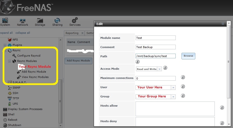

Ok ... I've got it. I'm using the rsync module for now, but next I may try moving to SSH. Then I will be able to backup anywhere in the world (provided I open the right port on my router). ;-)
Anyway, there were two pieces that were not initially clear to me. I will state them here in a hopes that someone else reads and is able to (more) quickly configure their own FreeNAS box.
1. The "Configuring Rsync Module Mode Between Two FreeNAS® Systems" really means "Configuring Rsync Module Mode Between Two RSYNC Systems"
2. "Rsync Tasks" under the "System" tree control on the left, is NOT where the rsync server module is configured. Instead it is configured under the "Services" tree control on the left (image attached).
