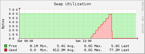

Hello All,
I have an HP N40L microserver now with 16GB of RAM & 3 hard disks, 2 x 1TB drives which are mirrored, and 1 x 3TB drive which is on its own.
I have run the system on 8.0.4 without issue, and for most of the time on only 8GB RAM. However i have wanted some of the features provided in later releases. I previously tried to upgrade to freenas 8.2.0 but when i did I had issues where my physical memory would fill up, then swap would fill up and then the machine would die. It was discussed briefly in another thread, but i rolled back to 8.0.4 before we could spend time figuring out the problem.
I recently discovered that I could upgrade my machine to 16GB of RAM so i did that, and decided to give the upgrade another try, this time with 8.3.0.
Unfortunately I am seeing similar behaviour, only this time the system seems to get close to falling over (all physical memory and swap is full) and something then happens to reset memory usage before it rises again. Behold the graphs below for physical memory and swap usage:
top shows at the time of the graph snapshot:
last pid: 24559; load averages: 0.30, 0.27, 0.28 up 1+11:40:41 22:55:31
33 processes: 2 running, 31 sleeping
CPU: 3.9% user, 0.0% nice, 6.2% system, 0.0% interrupt, 89.8% idle
Mem: 5800M Active, 31M Inact, 1467M Wired, 620K Cache, 172M Buf, 8445M Free
Swap: 6144M Total, 51M Used, 6092M Free

if i were to sample again later you would see smbd's memory usage spiral.

so the kernel log confirms that smbd exhausts all memory , then swap and so the system kills it from whence the usage starts to climb again.

10.0.10.2 (10.0.10.2) connect to service share initially as user erik (uid=1001, gid=0) (pid 21370)
[2013/01/05 17:54:08.811112, 1] smbd/service.c:1378(close_cnum)
10.0.10.2 (10.0.10.2) closed connection to service share
[2013/01/05 17:54:09.588775, 1] smbd/service.c:1114(make_connection_snum)
10.0.10.2 (10.0.10.2) connect to service share initially as user erik (uid=1001, gid=0) (pid 21371)
[2013/01/05 17:54:27.400563, 1] smbd/server.c:272(cleanup_timeout_fn)
Cleaning up brl and lock database after unclean shutdown
[2013/01/06 04:00:22.939791, 1] smbd/service.c:1378(close_cnum)
[2013/01/06 04:00:23.704075, 1] smbd/service.c:1114(make_connection_snum)
10.0.10.2 (10.0.10.2) connect to service share initially as user erik (uid=1001, gid=0) (pid 27925)
[2013/01/06 12:37:49.409255, 1] smbd/service.c:1378(close_cnum)
[2013/01/06 12:39:48, 0] smbd/server.c:1053(main)
smbd version 3.6.7 started.
Copyright Andrew Tridgell and the Samba Team 1992-2011
[2013/01/06 12:39:48.236977, 1] smbd/files.c:218(file_init)
file_init: Information only: requested 16384 open files, 11075 are available.

Erik Carlson
Aug 2, 2012
19
It will, yes - though occasionally you may write files over AFP that don't show up in a Windows browser without a refresh. I have been sharing single locations both AFP and CIFS always, and have never had any issues.
Can't help with the memory problem though, all this setup and the logs you've posted seem fine. Given your setup seems pleasantly simple, it may be worth running off a new 8.3.0 stick and reconfiguring from scratch - should only take ten minutes, and if it fixes the problem then that's a win.
Perhaps saving the config first and including it while logging this as a bug would be handy.
Hi Jamie,
Thanks again for your reply. There don't seem to be any other suggestions and I'm out of time so I want to try your ideas, but I'm afraid I have some newbie questions if you wouldn't mind.
1. I am happy to post the bug seperately including config files from both 8.0.4 before the upgrade and 8.3.0 after upgrading the earlier install, however looking through the files I am a bit concerned that they may contain recoverable passwords, or other security information. Do you have any suggestions for editing the file without rendering it useless for addressing the bug? Am I being paranoid?
2. I am happy to do the new install and redo the config importing the old volumes. but I am a little nervous about screwing up my data. I have a fairly recent backup but backing up that much data takes more time than I have. I looked at the pages at http://doc.freenas.org/index.php/Volumes, but these seem to be incomplete and the illustrations referred to in the text seem to be missing. Is Storage → Volumes → Auto Import Volume fairly easy to use ? anything I should look out for to avoid trashing my data?
3. Do you think it's worth me trying the "factory restore" and then reconfiguring before doing a fresh install?
Thanks
Erik
