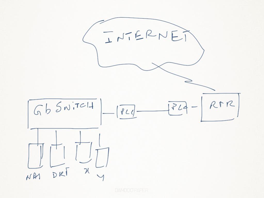

sonny81, just confirm. Is this your current layout?
sonny81
Aug 7, 2012
105
Yes that is my current lay out. I ordered an Intel PCIe nic and it should be in tomorrow. I think my nic is just acting crazy because I've tried all I read about. Setting mtu 9000 in the interface configuration didn't work and setting the command line to 1000mbps make my nic blink green a few times then if stopped working.
