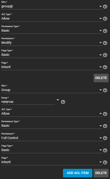

The user is part of a group which is set under Group in the ACL settings for the dataset I'm syncing to, the @group has ACL = Allow, Permission Type = Basic, Permissions = Full Control and Flags = Inherit.
Did you set the ACL on your dataset up using the who=group@ literal, or who=Group with the group name selected? The former is a link to "the owner group" which might not be identical to the group your replication user is a member of (eg: replgroup in my setup)

Hello HoneyBadger and thanks for the quick reply.
I've checked the dataset and it was set up as who=group@, I've added an extra ACL Item with who=group and specified the group (e.g. replgroup).
This has meant I no longer get the initial error at the start of the script:
rsync: [generator] failed to set permissions on "/mnt/pool-name/dataset-name/.": Operation not permitted (1)
Unfortunately, I still get the Operation not permitted on each file though and no files synced across:
rsync: [generator] failed to set permissions on "/mnt/pool-name/dataset-name/folder/file.txt": Operation not permitted (1)
Apologies if I misunderstood your explanation.
