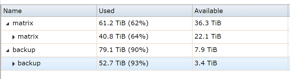

Well after running for a few days I received an email stating my backup pool was at 90%. For some reason now my backup pool is 17.9TB larger than my primary pool and the replication task is not complete.
I was expecting that the replication task would have seen what was different from the last replication and have copied over the changes. My primary pool grew about 6TB since the last replication on the SC847 before starting the new replication task. The new replication should have transferred the 6TB or so and been complete.
To me it seems like the replication task is ignoring what is already on the backup pool or needs a lot of extra disk space which doesn't make sense. The folder shown in the Storage tab of FreeNAS GUI between the two pools match up. However the size does not. I just deleted the replication task to stop the data transfer.
