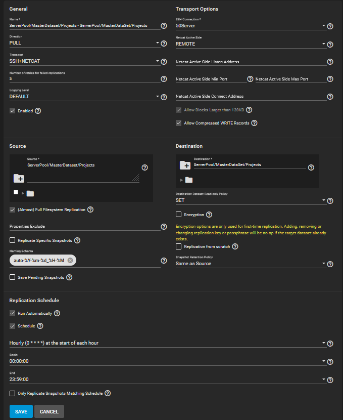

I tried to do it but below is the snip of replication settings, there is no option to uncheck "Resume Token"
