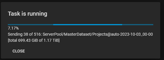

Looks like its going to take a couple of days to complete. Its been running for few hours now.
Once the replication is complete, I will confirm if the data is copied or not.

It finally came to the same point where the previous replication was failing, seems like there is an error in the snapshot of the primary system.
Below is my attached log, can you please help me solve this.

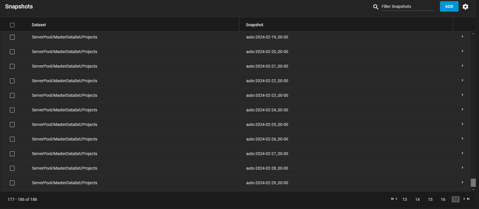

Below are the snapshots that are completed.
I have a feeling there is some kind of corruption in the snapshot of primary machine.
I don't believe in snapshot or dataset corruption, otherwise ZFS would be screaming.
