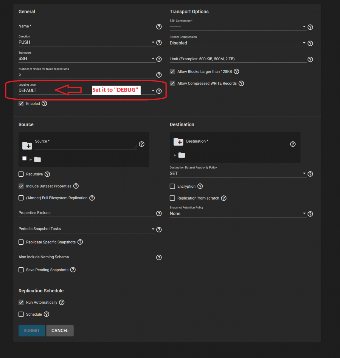

@urfrndsandy , before you do what @chuck32 and @artlessknave have suggested you to do, I would rather you explore the root of the problem to know what exactly is happening.
If you are using the repication via "Replication Taks" GUI, you can adjust your task in the ADVANCED REPLICATION" section "Logging Level" from "DEFAULT" to "DEBUG", save the change and run the task.
This is going to add all the details of the replication transactions and the results are going to be saved in the following file:
/var/log/zettarepl.log

It's an ambiguous statement from @urfrndsandy which needs clarifying, indeed.
If the issue is caused by rsync being applied toward a replicated dataset, then it should be easy enough to do a rollback of the last snapshot on the destination.
Hence, adjusting the "LOG LEVEL" in the replication task as it would clearly indicate the root of the problem.
If Rsync is really the issue, then an error of the type should be reported something like:
dataset at destination has been modified...

Thanks @Apollo and @artlessknave I think the first thing to do would be get hold of the complete debug log file zettarepl.
