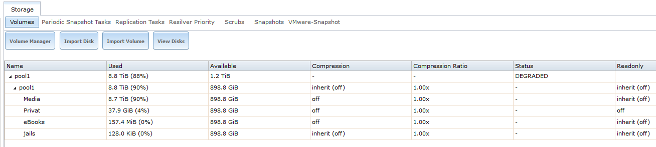

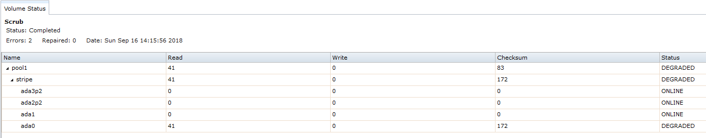

I did not pay attention to redundancy when creating the pool. My ZFS pool currently looks like this:
Volume Status:
If you could tell me what information is needed, I will share it here.

Volume Status:
OK, yes, that's a big problem. You have no redundancy on your pool, you already have data errors, and you've been messing around with the pool at the command line. Your pool is also way too full, but that's a secondary issue at the moment.
My common sense tells me if I simply swap out a hard drive full of data, that data will be lost.
Normally no data will be lost, because most FreeNAS users (at least as far as we see here) care about their data and therefore have redundancy on their pools. You've set up your pool with no redundancy, and are seeing consequences of that--you're already losing data, and you won't be able to take a disk offline to replace it. You wouldn't just lose the data on that disk; you'd lose all the data on your pool.
Do you have another SATA port available? To make this work, you will need to have a fifth disk online temporarily. It doesn't need to be pretty, and it doesn't need to be mounted internally, but it'll need to be connected and online.
