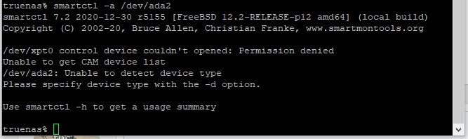

Thank you for your detailed advice. I did as you suggested. Unfortunately getting the results to you didn't work out. Shell won't allow any copy/pastes. I read that I should use ssh and putty. After going to great lengths to do that, I ran the same command in putty, but it fails there, as you see here.

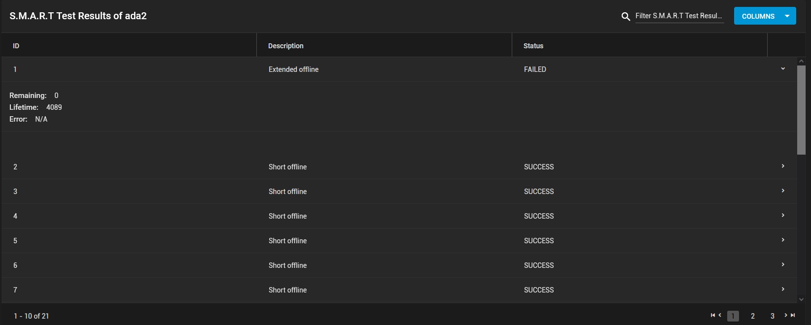

Just a minor aside, I was bemused to find this result in the GUI; it's not clear to me if it means the test 'failed' to run or if the test ran to completion and it's finding is that the disk 'failed' the test. I was also surprised it doesn't actually show the test results heavily implied by the preceding link, entitled "S.M.A.R.T TEST RESULTS", but that's another matter.
