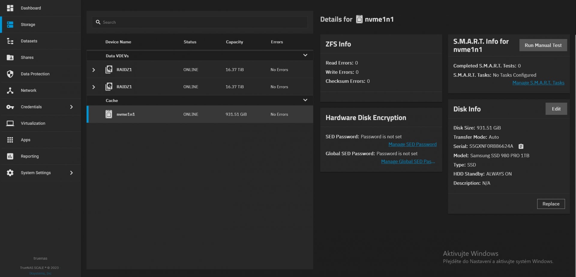

No matter how hard I search, I simply can't find the function or setting to remove L2ARC cache from the data pool. Am I completely blind, or is it simply not possible to do it in the graphical user interface (GUI)?
Thank you in advance for your help.

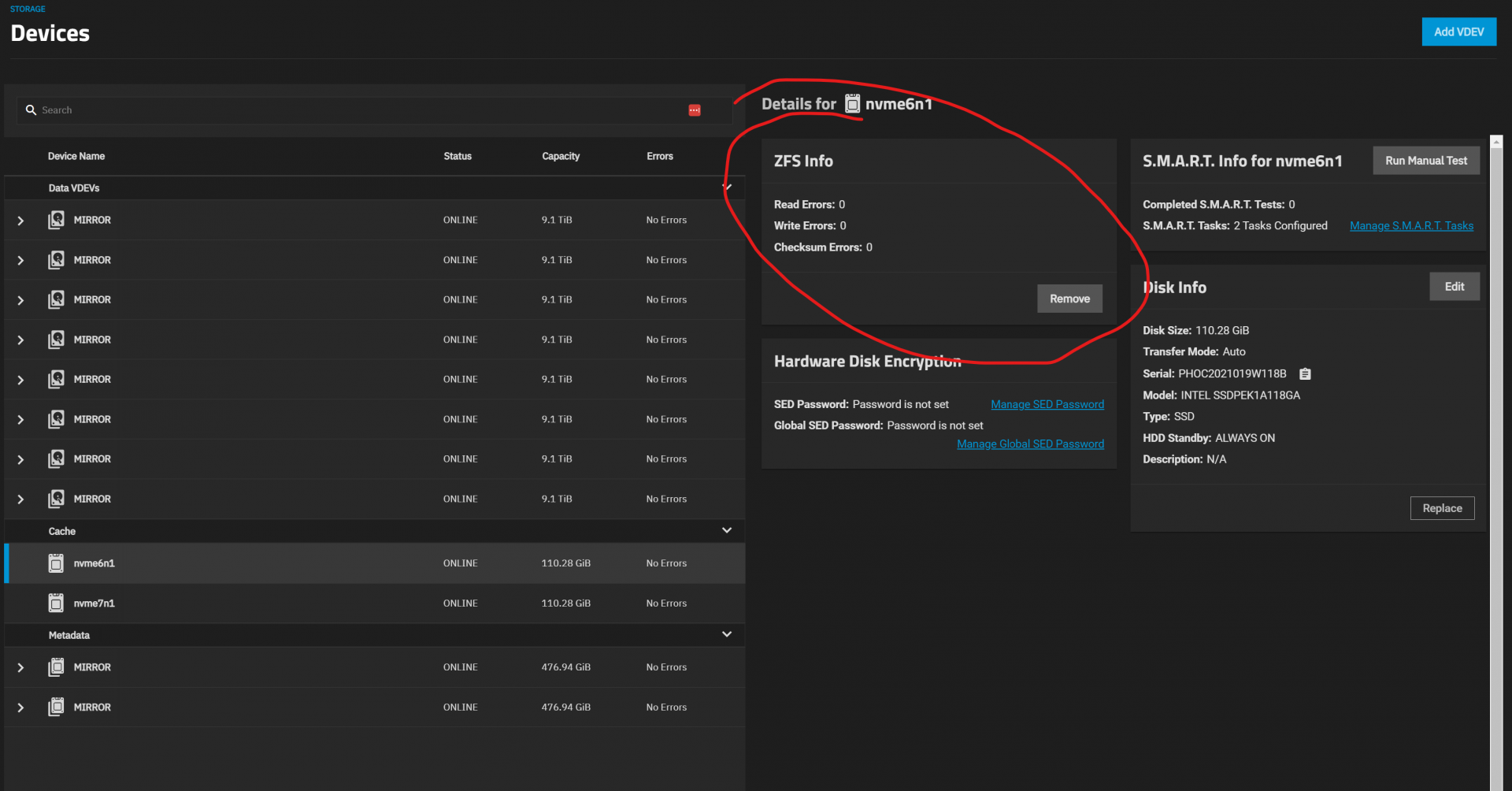

Storage -> Pool -> Manage devices

its just not there....

If I remember correctly, it seems that ZFS cannot remove special vdevs from any kind of RAIDZ pools as of OpenZFS v2.1.4.
You seem to have a RAIDZ1 pool, NickF‘s pool consist of mirrored vdevs. That’s why he can remove vDev and you can’t.
i can remove it. but just via shell.
with
$ sudo zpool remove pool l2arc-device
worked.
so the question is, why i cannot do it in gui. make a little bit no sense.
Pools are not characterized as RAIDZ, vdevs are. You might only have a single data vdev in your pool though.
Normal L2ARC can be removed from any pool type and should be removable. It could be a GUI issue of some sort.

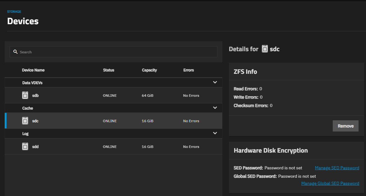

23.12.3.1 is definitely missing the GUI button to remove L2ARC or SLOG devices from a pool. i was just experimenting with SLOG and had to use the CLI to remove.
Just created a test pool on 22.12.3.1 and I have removal options for both the L2ARC and SLOG (single or mirror) devices.
Can you force-refresh and/or clear your browser cache and check again?

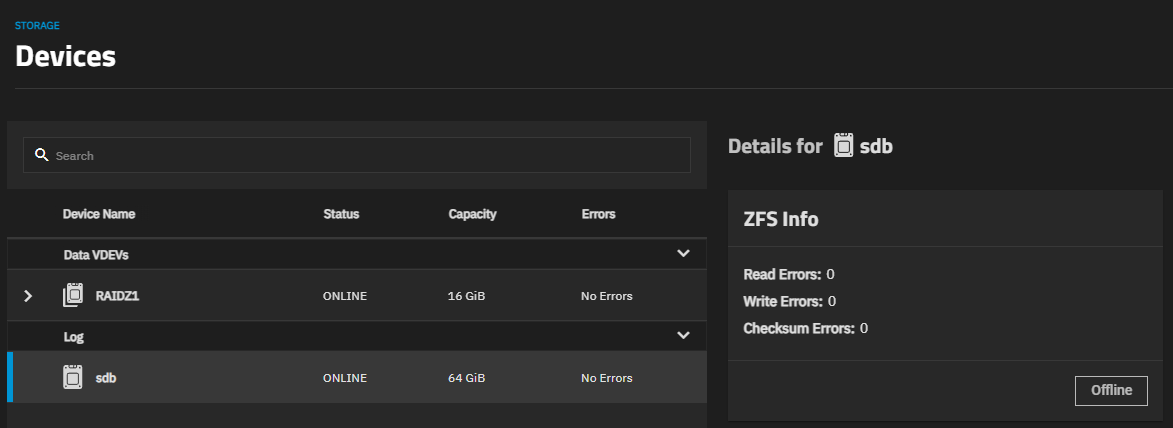

5,112
Apologies again - you are correct, with a top-level RAIDZ vdev it is not offering options for removal of cache and log vdevs.
This is correct, but cache and log are not treated as special vdev units, they are different. I would expect the REMOVE to be missing from those vdev types here. Seems like a UI bug may have been introduced in 22.12.3 or .1 as I don't see it on an older 22.12.2 install.
