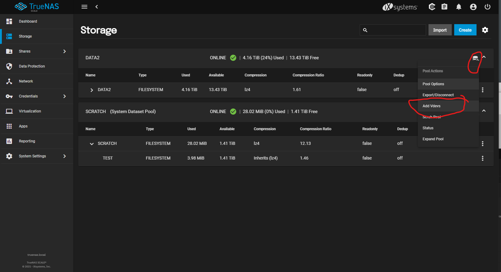

My mistake I tried to create the L2ARC from the create button at the top of storage. Using the configure button of the pool and adding another vdev => cache allows the addition of the device to the pool. From a UI point of view maybe could be cleaner?

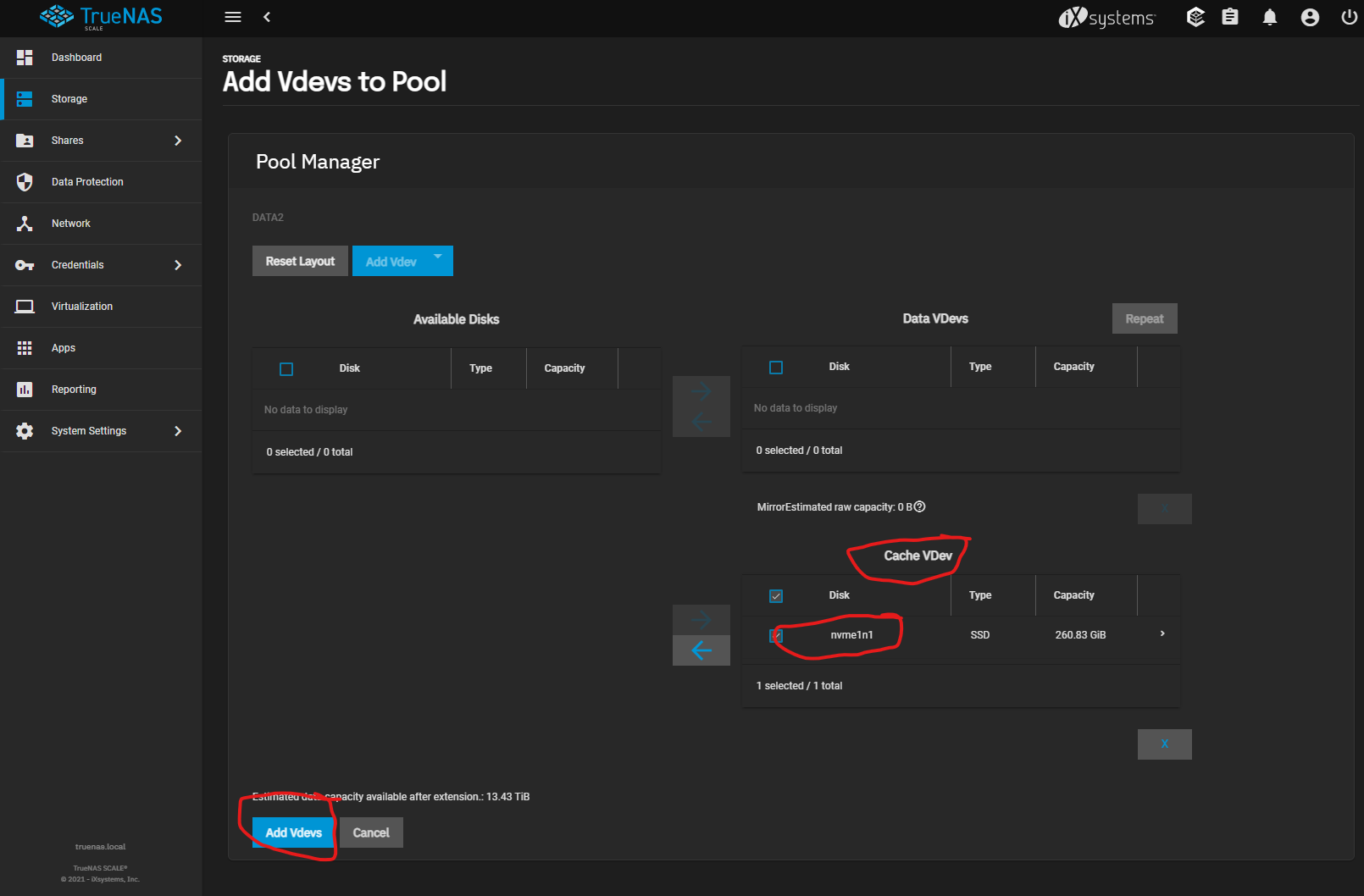

Hi ornias,
This is how I attempted to add the L2ARC incorrectly:
This allows you to add the L2ARC or SLOG as a place you can assign drives too but won't allow you to create the device. It seems to be a UI dead end.
The way I got it to work is as follows:
