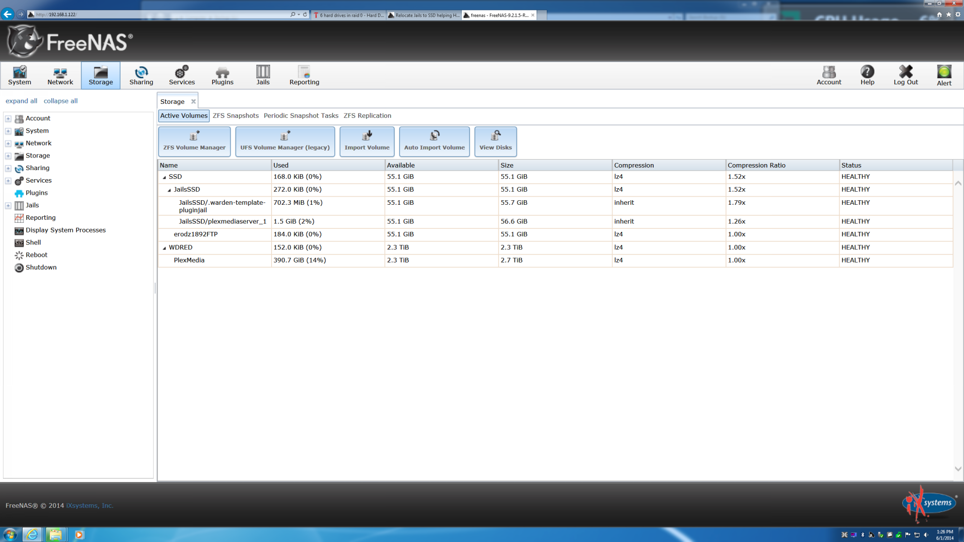

Was just looking at this thread last night, had the same problem I really wanted the HDD to sleep and from what I understand is that the HDD will not sleep unless the Jails are in other location ie SSD I don't know how to check that the HDD is sleeping or spinning down I did the proper set up in the disk to spin down in 30 minutes. Here is what I ended up with,
