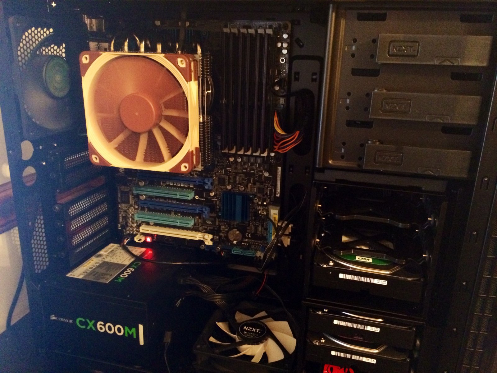

Hello, sorry to jump here being reading on how to save some Watts I currently upgraded my machine and the power consumption wasn't was I was expecting. Currently considering removing the GPU but not sure if that's going to have a big effect on it. Or maybe replacing it with a more efficient one
Previous specs
AMD A8 7600(45W), 16GB Ram , mini ITX form factor, 2RED drives(data), 1SSD (jails) 1 120mm fan. pulling 45W idle
working with AMD prove to be a bit of a pain trying to figure Temps and Freq the sensors aren't really tuned or optimized freq scaling was another problem with AMD cool and quiet interfering with pwerD and many more
Current Spec Xeon L5640(60W) ASUS P6X58D motherboard,24GB ddr3,Sapphire Technology Radeon HD 5450 Low Profile, 2Red Drives,1 Green drive, 1SSD. . 4 120mm fans. Pulling 110W idle
I just almost triplicated the power consumption by switching to this parts I am impressed with the performance of the new machine but really disappointed with the power consumption electricity here is at .0933 Kw not sure if I actually won on this deal of shot myself in the foot. Opinions are welcome

I wouldn't be surprised if:
1. Your motherboard doesn't use power management functions that FreeBSD uses since it's not really "server-grade".
2. That video card is a killer for power usage.. ditch it. Ideally if you had gone with "server-grade" you'd probably have a built-in video card that would use like 2w and you'd never have to care about it again.
My X9SCM-F with 32GB of RAM and server-grade stuff ran 35w idle with no hard drives... so I'd guess that 50w would have been overstating what it would have been with 3 hard drives attached compared to your setup. :/

Nehalem, Westmere, really anything before Sandy Bridge, not that great on the power consumption end of things. Expect your "60W" CPU to be using a lot of that.
Good god get rid of the GPU. That's another 10-20 watts of worthless.
Make sure your fans aren't running at full speed. That could burn lots of watts, depending on the fans.

I can only see a few things you can do to reduce your power consumption...
1) Once your system is fully configured and boots reliably, power it off, remove the video card, power it back on. If it boots up fine then you have reduced the video card power consumption.
2) Underclock your CPU, however generally you will not drop much power consumption but a few watts and if you underclock too far your system will become unstable. If you do this then you must run stability tests like MemTest and Prime95 or similar. I am not a fan of underclocking for power consumption reasons, as I said you don't save much.

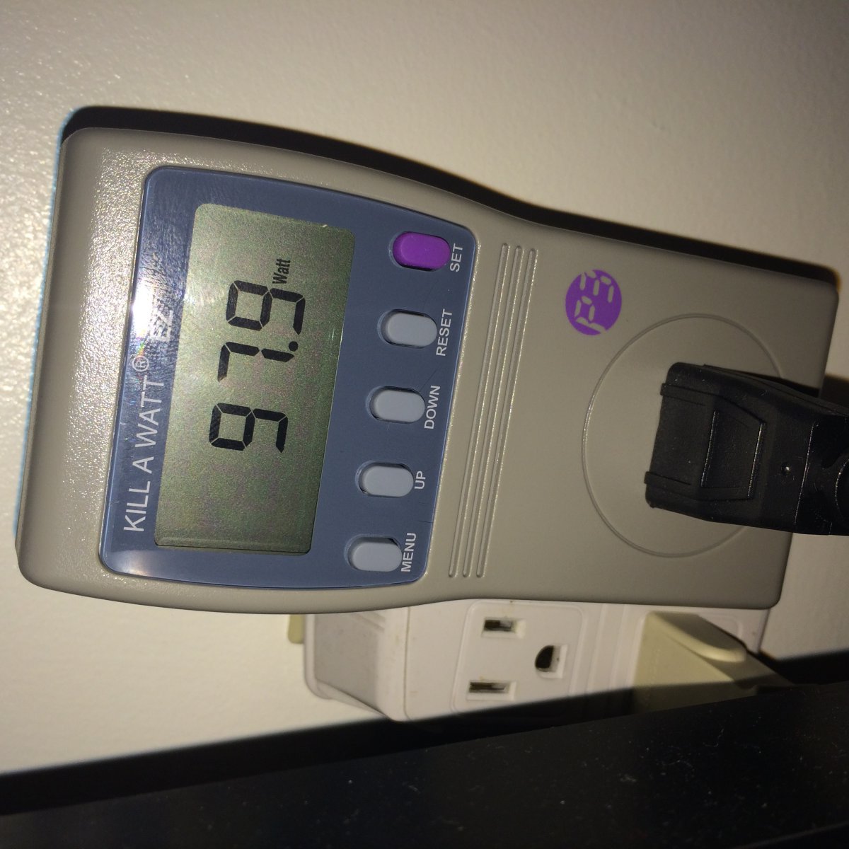

Many thanks ! following directions seems I am heading the right way, got it to work following these as well passing the error on the bios http://forums.freenas.org/index.php?threads/no-video-card.3895/ from an idle at 110W went down to 98W by removing the GPU and disabling one 120mm fan that's all the drives running have them on spin down to 20 mins ill have to wait to see those results. I do have another Xeon CPU the L5630 this is the same CPU L5640 except runs at a slower freq and lacks 2 cpu cores of a max TDP of 40W I do a lot of trans coding so I would prefer to keep the one I am using and I am skeptical of idle usage of both CPUs should be really close.(update) disk sleeping went further down to 92W !! at this pace is going to cost $7.70 a month way better than before. Doesnt seem so bad after all is fine if I went from 45W to 92W but gained a better platform AMD was really a pain to deal with. Many Thanks!
