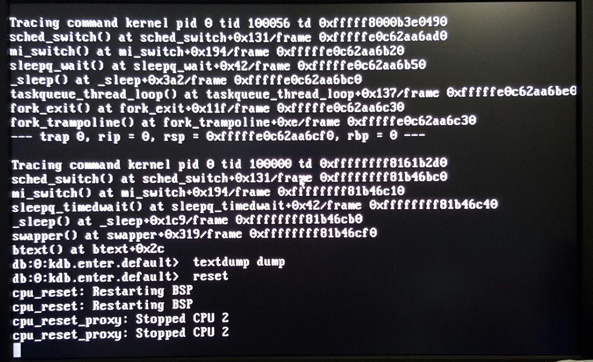

After installing FreeNAS to a USB stick, the system starts up initialises services, does a bunch of 'stuff' (to much stuff on the screen moving too quickly for me to see), and then after about 5 minutes of doing whatever it is doing - it reboots.
I have tried using 4 different USB sticks (both for the ISO image, and as the target for the installation).
I have tried installing both the 9.3 Stable and 9.3.1 nightly builds, but I get the same result on both. Note that attempting to install the same iso in VMWare, worked without a problem.

The attached file is the last thing I see on the screen before the reboot.
