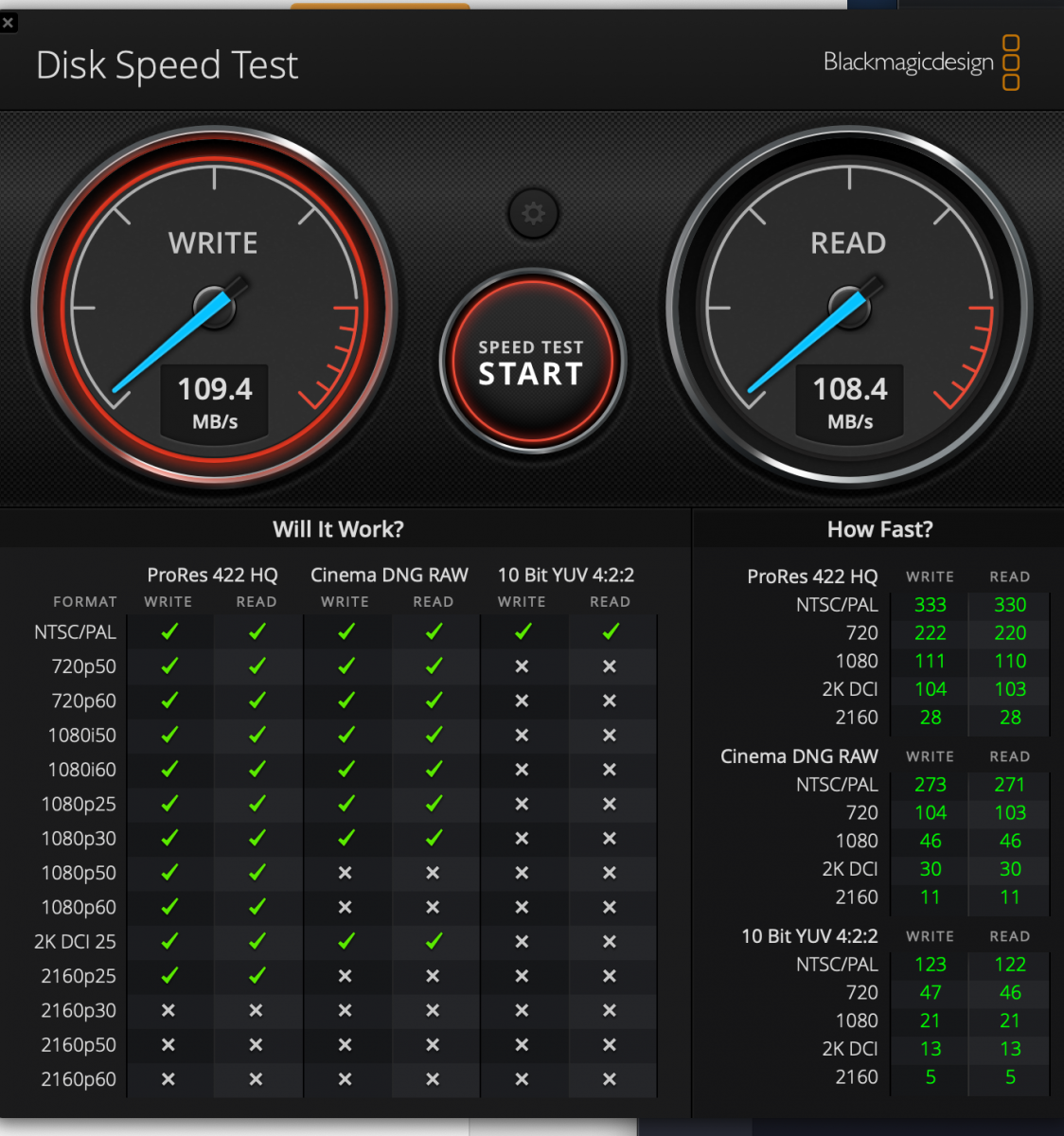

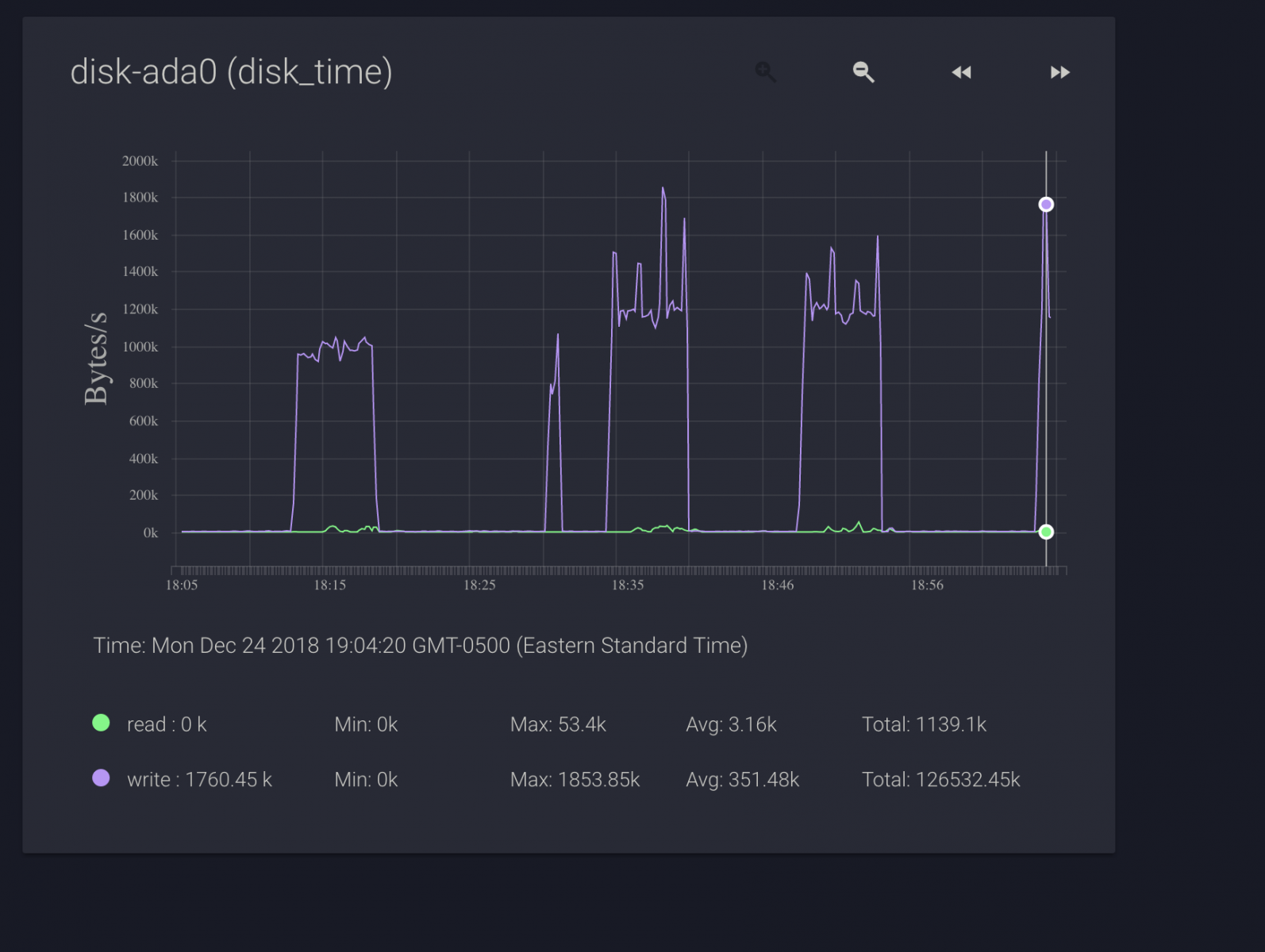

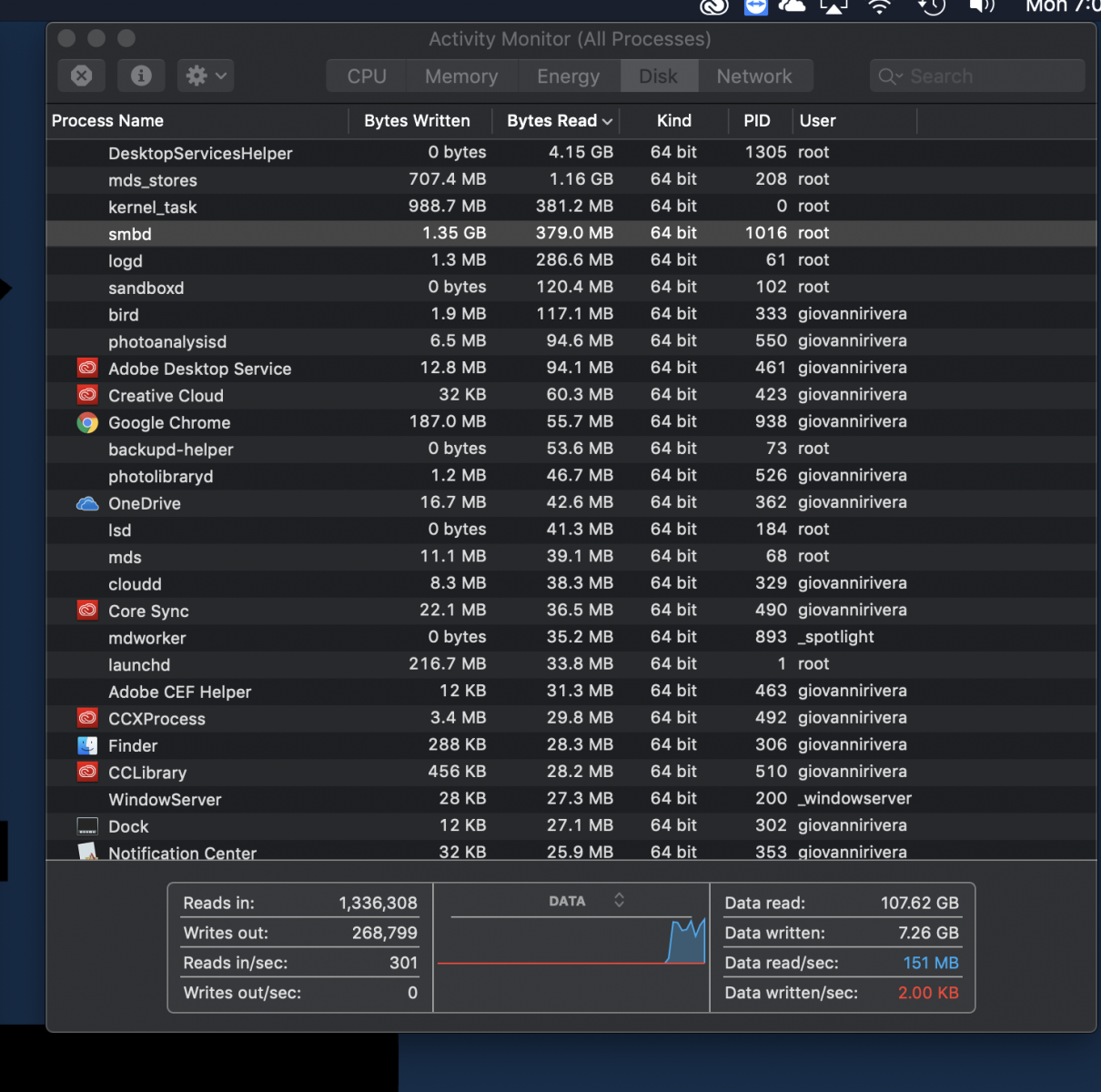

I just build my first FreeNAS and something is confusing me about Data Transfer Speed when I move a folder from my PC(iMac ) to my FreeNAS Share folder the speed of reading on y iMac saids 151MB but on my FreeNAS the Write saids 1760.45k that's very low on the FreeNAS if is kilobytes or I'm looking at the wrong information. If I'm reading the wrong info. What is the proper way to read. I also did a test on BlackMagic of my FreeNAS Drive and it saids 109MB/s write and 108MB/s read
Pardon my ignorance but is just a bit confusing the way FreeNAS shows that info.

The current UI has some issues to get ironed out. Confusing and/or wrong charts is one of them. For example, my CPU temperature on a historic basis shows about the right temperature (˜25*C) but current temperatures are always in the 0*C range. That would be quite a feat by the cooling system considering that the ambient temperature is 21*C, it only uses a fan, a heatsink, some paste, and a shim to keep the CPU die cool.
I'd focus more on being able to transfer about 100MB/s, which is close to the limit of gigabit Ethernet. You're likely only to get that with large files, small file transfers tend to be slower. For example, Time machine backups never seem to go beyond 50MB/s on my system, despite a SSD source, a 10GBe connection, a 200GB SLOG on the NAS, etc. Some processes are simply slow.
