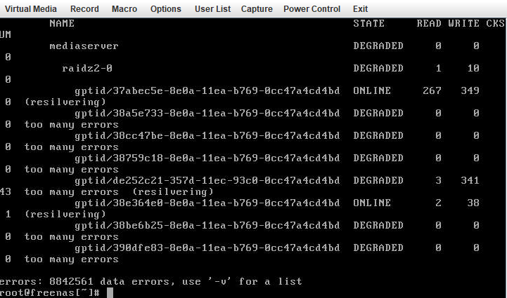

I seldom write or ask for help but this time its maybe a big issue for me. So I had a faulty disk, ONE and out of I dont know why, shut down the system pulled it out and replaced it with a new one. After I put in the new one, starte NAS and replaced the faulty disk. After 8hours I checked and my nas was not accessible anymore over web. So I checked with my i/o port and saw that it crashed. Still can access command line but zpool status shows ALL disks are degraded now. So
I restarted the nas and after about 15mins its in the same status where web isnt accessible anymore. So I thought put in the disk you pulled out where it was and plugin
the extra on a different port, but also the same problem after about 10mins.
So I have no clue now what todo and just hope with help I can save my data as I have no Backup. I use the onboard Raid controller and an extra SATA controller which also might have made the problem accure but thats not what I want to discuss. I really would like that it runs again and my data is back. Have to say that this setup runs now for about 5 years with no problem at all.

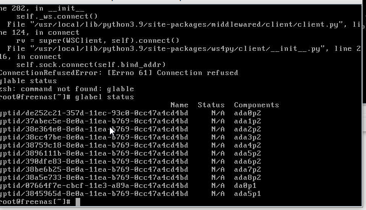

glabel status should point you to the list of disk names you need to use
It seems you have at least ada8 as one disk in the system from that last screenshot.
As far as I can tell, that does not look good, right?

With SSH over Putty I also can scroll up and down and see much more info. The resilvering is still going on
pool: freenas-boot
state: ONLINE
status: Some supported features are not enabled on the pool. The pool can
still be used, but some features are unavailable.
the features. See zpool-features(5) for details.
scan: scrub repaired 0B in 00:13:09 with 0 errors on Tue Oct 19 03:58:09 2021
config:
NAME STATE READ WRITE CKSUM
freenas-boot ONLINE 0 0 0
da0p2 ONLINE 0 0 0
errors: No known data errors
pool: mediaserver
state: DEGRADED
status: One or more devices is currently being resilvered. The pool will
continue to function, possibly in a degraded state.
action: Wait for the resilver to complete.
scan: resilver in progress since Mon Oct 25 12:25:30 2021
1.81T scanned at 555M/s, 697G issued at 209M/s, 11.2T total
79.4G resilvered, 6.07% done, 14:41:40 to go
config:
mediaserver DEGRADED 0 0 0
raidz2-0 DEGRADED 1 10 0
gptid/37abec5e-8e0a-11ea-b769-0cc47a4cd4bd ONLINE 3 60 0 (resilvering)
gptid/38a5e733-8e0a-11ea-b769-0cc47a4cd4bd DEGRADED 0 0 0 too many errors
gptid/38cc47be-8e0a-11ea-b769-0cc47a4cd4bd DEGRADED 0 0 0 too many errors
gptid/38759c18-8e0a-11ea-b769-0cc47a4cd4bd DEGRADED 0 0 0 too many errors
gptid/de252c21-357d-11ec-93c0-0cc47a4cd4bd DEGRADED 3 350 0 too many errors (resilvering)
gptid/38e364e0-8e0a-11ea-b769-0cc47a4cd4bd ONLINE 2 60 0 (resilvering)
gptid/38be6b25-8e0a-11ea-b769-0cc47a4cd4bd DEGRADED 0 0 0 too many errors
gptid/390dfe83-8e0a-11ea-b769-0cc47a4cd4bd DEGRADED 0 0 0 too many errors
errors: 8842561 data errors, use '-v' for a list
