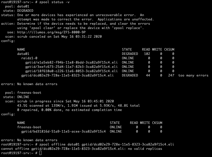

A few days ago i got some smart errors on /dev/da0. So i ordered an replacment device.
Now i tried to take the disk offline in the pool, which brings me an errormessage "no valid replicas".
I started an Scrub, which finishe without errors a few minutes ago. I tried again taking the disk offline, but the same errormessage appeared.
What can i do now? How can i replace the faulty disk?
If i check zpool status:
I also started an new scrub, the last one i stopped.
Strange part to me: If you look at the disk which is "DEGRADED": Why is this disk not in the "raidz1" group??!

My disks which are members of the pool data01 are named /dev/da0, /dev/da1, /dev/da2 and /dev/da3.
/dev/ada0 is my boot pool.
Do you think my pool data01 is completely lost?
Im a bit confused, because if i look at zpool status one disk (this is the degraded one, so it muste be da0) seems to be „outside“ the raidz1.

Your pool is safe, for the moment, but if you lose another drive, it'll be unrecoverable. You'll need to backup the contents ASAP.
Once your data is safely off the system, destroy the pool. You can replace the disk then. I recommend you recreate the pool as RAIDZ2, which will allow for the loss of 2 disks before you run out of replicas. If a member disk then becomes DEGRADED, you can take if OFFLINE, pull it, and replace it.

Freenas on latest version, having one pool as RAIDZ1.
No you do not, you have 3 drives in a raidz1 vdev and a striped single drive that is degraded. That is why you cannot offline it, you need to finish the backup and recreate the pool properly
Thank you for this information. This explained it.
So this is not a "correct" Raidz1?
Will destroy the pool after backup is finished, replace /dev/da0 and recreate raidz1 with all 4 disks.

Fyi: you are incredibly lucky the disk didn’t outright die, then you would loose the pool
15,504
No, it isn't. As Garm said, you created a RAIDZ1 with three disks, and have a fourth disk (likely one that you thought you could add at a later time, to turn a three-disk RAIDZ1 into a four-disk RAIDZ1) striped with that RAIDZ1. If that disk completely fails, your entire pool will fail.
