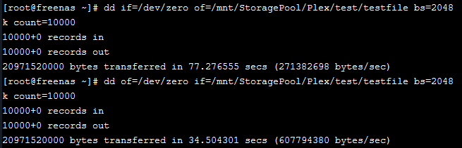

Here is a screenshot of a DD test I just ran. Read performance seems to be over twice that of the write performance. :thinking:
Is it SMB related?

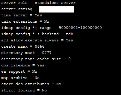

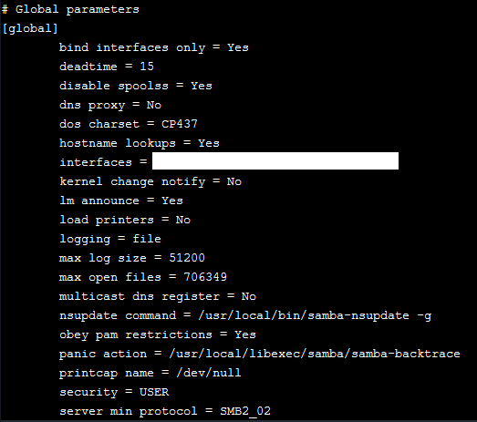

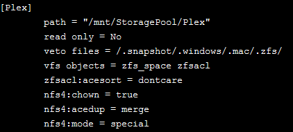

Outputs of smb4.conf including Plex dataset info. I made sure that the dataset, in this case "Plex", I ran the DD tests on has no compression. In the first of the next three screenshots I blanked out my interfaces... one is localhost, the other two are on my local network on different subnets. The second one not on my "true" network is just there as a "failsafe" so that if one port dies, the server will still be reachable (static route setup in main router (DHCP server)).
