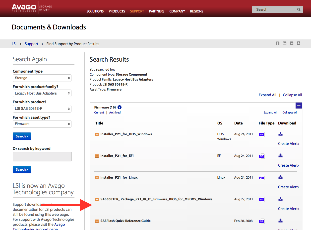

I think you're wrong. That's exactly the card I have, except mine has a bracket, and I now realize that for practical purposes it's identical to the one you found on eBay before, because the underlying controller is an LSISAS1068E. If you want to go with that card, you should be able to get it used on eBay for a lot less than $79 (I'm sure I could ship mine to you for less than that). Also, make sure you have the correct cable to connect the card to your backplane and the correct PCIe riser to install it in.
You will need to flash the card to IT mode to use it with FreeNAS, which I discovered last night is really easy using the package you can download from lsi.com (see attached image). After downloading the package, you need to make a bootable DOS disk and copy the right files to it. Then you restart from the DOS disk and run hbaFlash.bat and it literally walks you through the whole process.
Having said all that, this card has the limitations we discussed earlier, e.g. individual disk capacity limited to 2TB. But it works (I have mine installed in my T110 right now).
As far as backup is concerned, the key point is that RAIDZx is not backup. If the valuable data on your FreeNAS is a backup of data stored elsewhere, as mine is, then backing it up again may not make sense. However, if the data on your FreeNAS is the only copy, then you need to devise a backup strategy for it.
EDIT: when hbaFlash asks what type of card you have, choose 3081.

Good advice but get the LSI "P16" firmware bundle or you risk a mismatch between the firmware and FreeNAS mpt driver, which expects v16 firmware on card.
I thought about that, but I figured it wasn't applicable to this card. I have no warning in FreeNAS.
