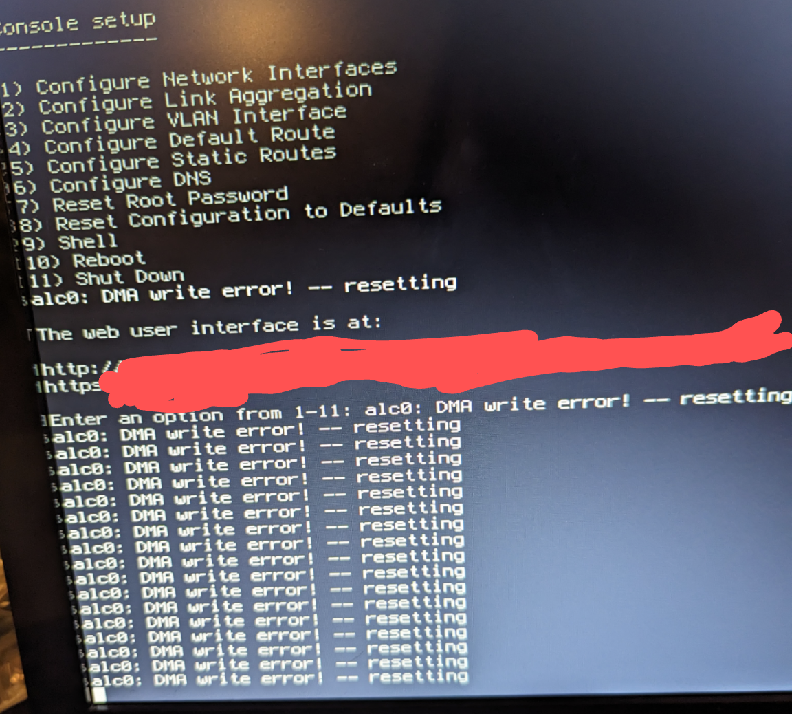

2. The command line is constantly outputting this error (image 2). I am not sure if it affects functionality but should care about this?

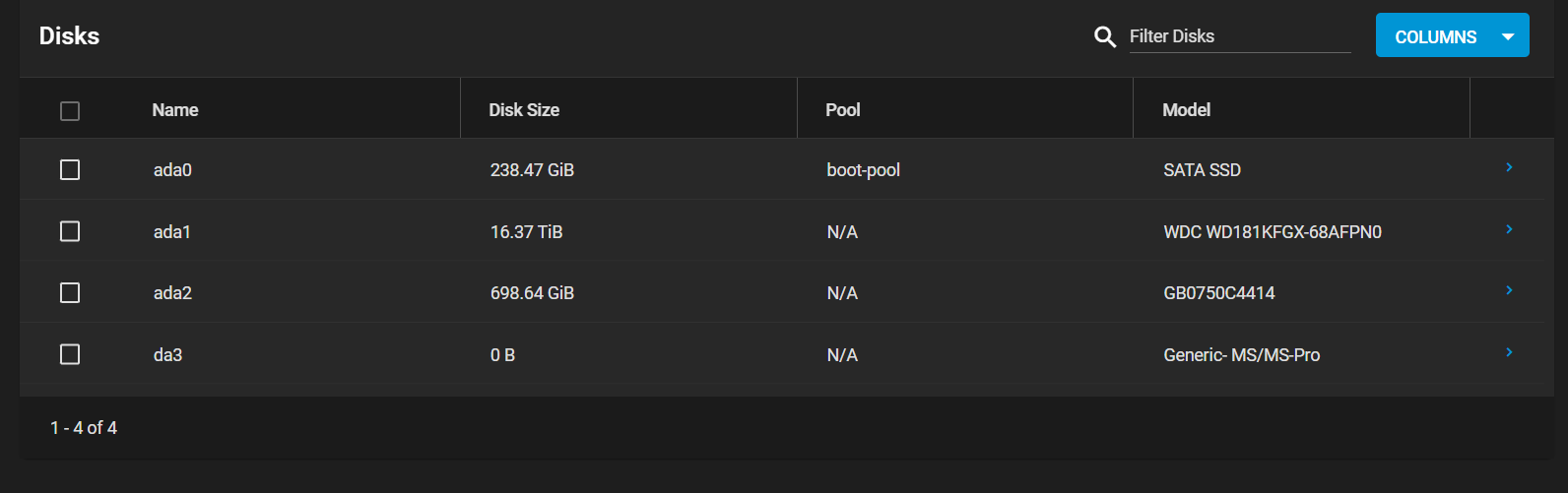

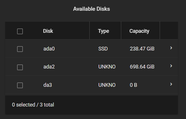

I did some messing around and apparently the server was still booting from the 18TB HDD, so I fixed that so it boots properly. There still is the strange "da3" disk
which appears under my list of disks even though there are only 3 disks attached (image 1). Problem 1 seems to be solved and I can just pool the 16.37TiB drive now and all the other drives are showing, should I just ignore the 0B drive? Apart from that my only remaining question is should I fix my problem from #2 of the initial post?

Arwen
May 17, 2014
3,611
Some keyboards, USB hubs and even chassis include a memory card reader. Even if it is inaccessible, (my USB keyboard / mouse switch insists it has Gigabit Ethernet, except no port for it's use...).
So I would not be too concerned about "da3". This board does seem to have this, which might be it;

Yes! That was what da3 seemed to be. I removed the front io and da3 is not on the drive list anymore.

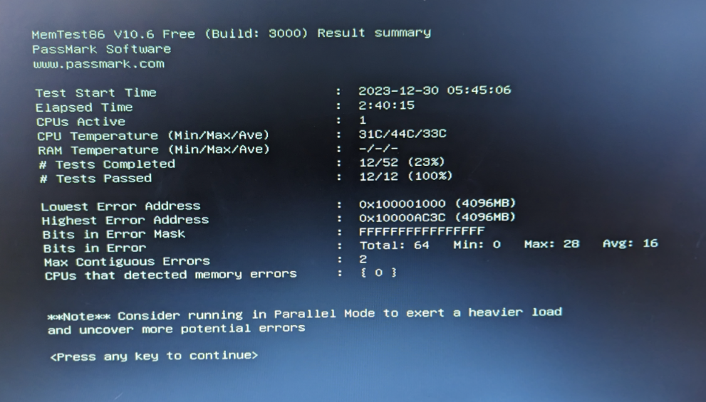

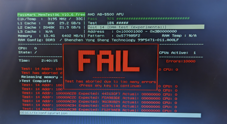

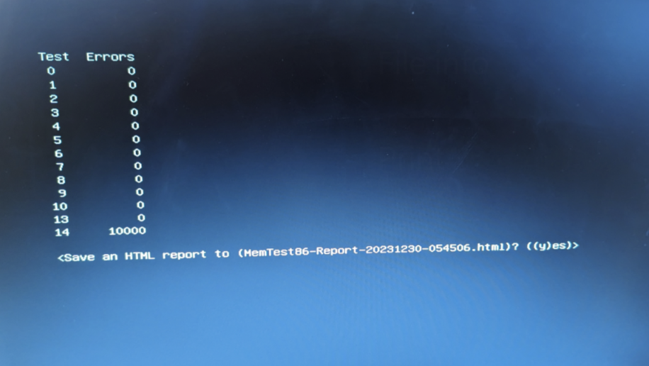

I ran MemTest86 and I got no errors except on the last test (images 1-3). I didn't communicate properly that by "cheaped out on cooling" I just meant I am using 1 case fan and a stock CPU cooler, so I don't have an exposed CPU heatsink to feel for temperature on. To perform the test and protect my CPU from overheating, what would I do (I don't have access to an infrared thermometer)?
Questions remaining:
1. Is the error "DMA write error" important or should I ignore it (if so how should I fix)?
2. How do I perform the suggested tests?
DMA stands for Direct Memory Access. Test 14 is listed as experimental and since only that test failed, you might be okay BUT, I would now run the MemTest86+ test just to cover your bases. Here is the URL to grab a copy, be aware there are a lot of adds that say "Download" or what-not. Download the Latest Version and run this. Make sure it passes at least 4 complete times, or run it overnight. The goal is to ensure it does not fail. If it asks you to buy the program, stop and do not.
If MemTest86+ shows a failure, then unplug the system and remove the RAM and reinstall it. Test again.

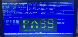

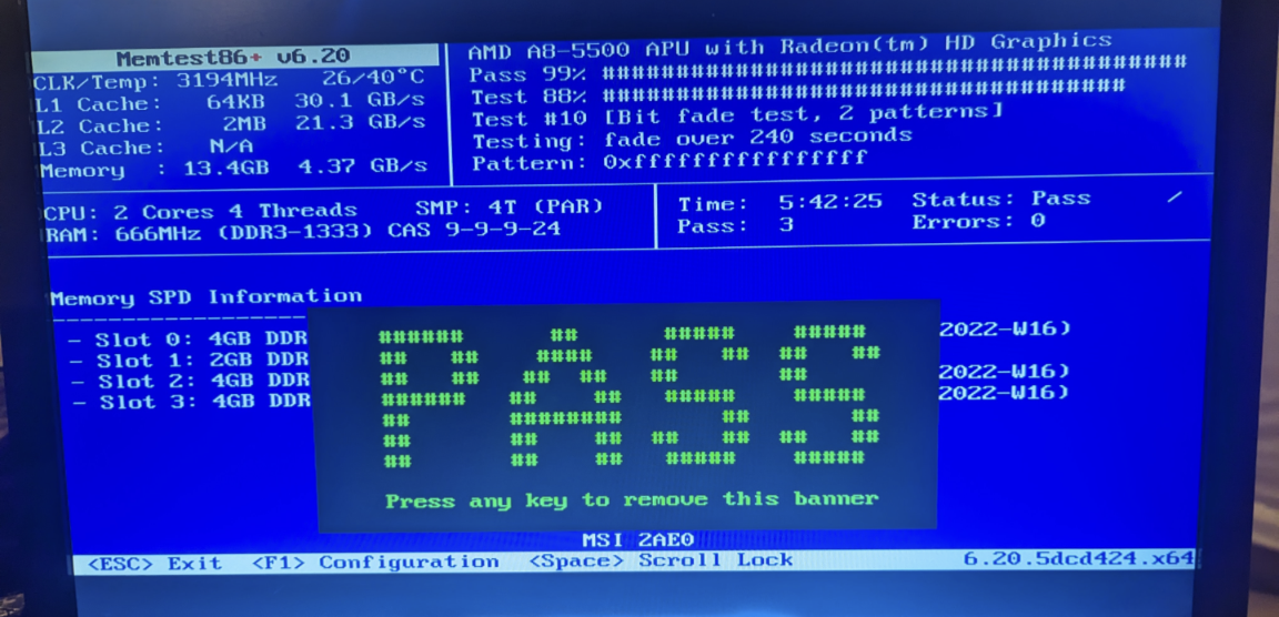

Ok, so I ran MemTest86+ and verified that 2 passes had 0 errors. I tried doing 4 passes but the 2 passes already took ~24+ hours. When I checked on the progress at ~30hrs the power went out and the progress was lost. I assumed 2 passes over such a long time is probably good enough but if not I can run it again. Images 1 and 2 are of the info on the MemTest86+ screen.

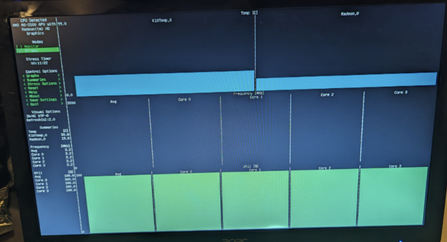

I ran a CPU stress test on Ubuntu with the apps "stress" and "s-tui" and had no problems over 30 min, the graphs were essentially perfectly flat at 100% and the temps were low (I presume good cooling, open case, and low ambient temperatures help). Image 3 is not of the results at 30min (I forgot to take a picture before exiting) but the graphs did not change at all the entire time.

I would have to say that your system appears to be stable based on those two tests.
Your NIC could be the issue. The NIC you have should be "Atheros AR8161L" and I personally have never heard of that before. That doesn't mean it's the issue but I suspect it is. If it were an Intel NIC, I wouldn't question it.

RealTek has terrible support with TrueNAS, so it does make a huge difference, but your specific NIC I have never heard of so I have no idea if it's well supported or not. You cannot think that every piece of hardware has the same support, it does not work that way unfortunately. This is not an Apple world where hardware has to meet very strict requirements.
But if you are unable to move files around form the command line interface, you have larger problems. As I said, maybe it's a privilege issue but for now the NIC is on the back burner until you can figure out how to move files around.
Maybe TrueNAS just does not like your hardware at all.
Have you tried TrueNAS SCALE? It is build on Debian vice FreeBSD. It has different drivers, maybe this will work for you.
