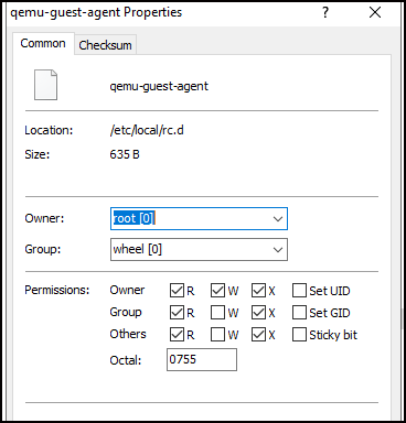

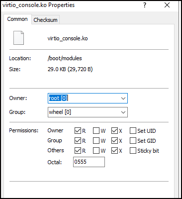

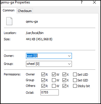

I set mine up by SSH'ing directly into the TrueNAS server (not via the TrueNAS Shell). From checking the past commands I ran, those were:
kldload virtio_console.ko
chmod +x /usr/local/bin/qemu-ga
Also make sure you have the permissions set correctly on each file. I use WinSCP. I've attached some screenshots.
