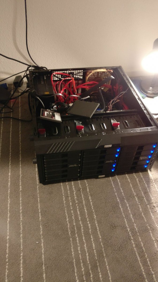

For the heck of it here is also an image of my currently open NAS with things just dangling out, be heart attack prepared
