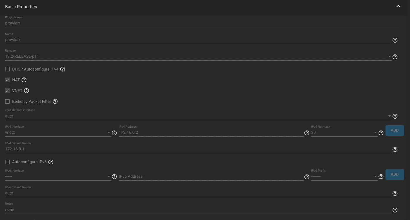

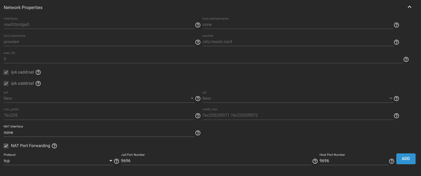

These are the Basic and Network settings from the prowlarr jail:

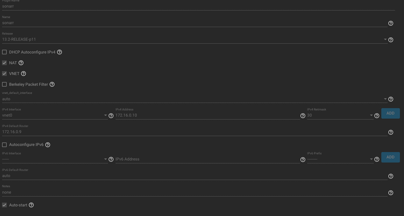

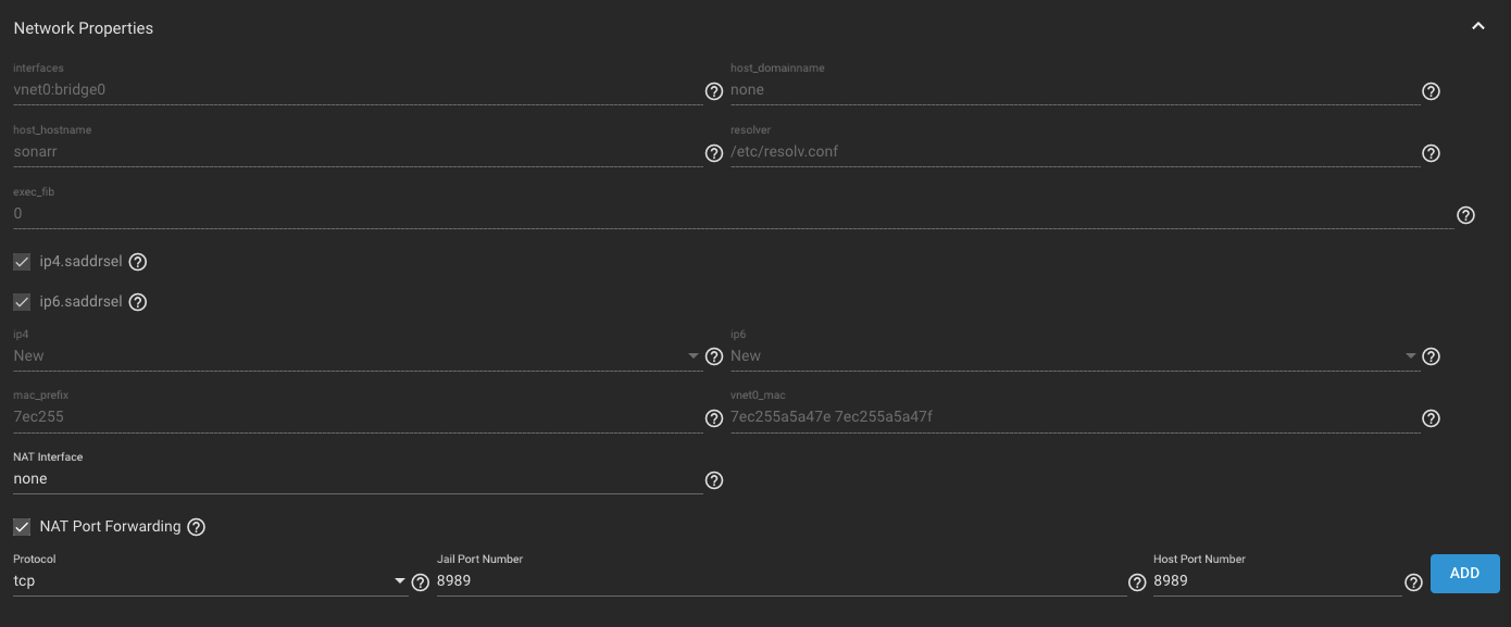

and these are the ones from my sonarr jail:
There are some threads with a similar problem but without any solution... maybe NAT is causing issues?

I think there is some issue with the NAT port forwarding because when I am in the prowlarr jail I get this:
root@prowlarr:~ # nc -zv 192.168.1.194 8989
nc: connect to 192.168.1.194 port 8989 (tcp) failed: Connection refused
But there should be a NAT Port Forwarding for this port so this should work right?
