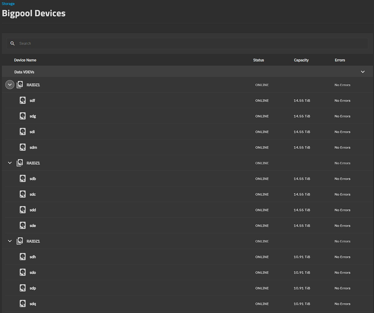

I have a pool that has a VDEV that I am attempting to resize by replacing a single drive at a time. It is a 4x12TB Z1 VDEV that where I have replaced all the 12TB drives with 16TB drives. It is in a pool that has three z1 VDEVS (one 16TBx4, one 12TBx4, and this one, which is a 12TBx4 that I'm trying to upgrade to 16TBx4).
I offlined each drive prior to replacement. Removed the offlined drive (I didn't have a spare slot). I slotted the 16TB drive and triggered the replace process. TrueNAS put the VDEV into degraded status each time, but resilvered and the VDEV was healthy again. I repeated this three more times.
At the end of the process I expected that the pool size would increase. But after the 4th drive finished resilvering the pool size did not change.
I am running Dragonfish-24.04-RC.1.
I've done a fair amount of research on others with the same issue. So I've tried the following:
1. I've rebooted TrueNAS Scale
2. I've confirmed autoexpand is turned on with the zpool get autoexpand command
3. I've turned off and turned back on autoexpand with the zpool set autoexpand=off and on commands
4. I've used the zpool online -e command for each of the drives in the VDEV
None of these solutions have resolved my issue. The one clue that I don't understand is why the GUI is showing two VDEVs with the 16TB drives (14.55TiB), but when I run a zpool list -v bigpool command I see the following:

My research hasn't uncovered anything else to try. Any suggestions? Might this be a Dragonfish bug?

I think you are right. I have run the lsblk command and sorted the drives in the sequence of the VDEVs (the first 4 are my 1st 16TBx4 which is working fine, the second 4 are the new 16TBx4 which won't expand, and the last 4 are the 12TBx4 which is working fine).
lsblk -o name,partuuid,fstype,size

Based on being able to search on "lsblk" and "expand" I found this thread: https://www.truenas.com/community/t...ty-not-expanding-23-10-1-cobia-solved.116337/.
Based on the results of my lsblk do you think I've run into the same partitioning SNAFU?
It looks like it; /dev/sd{bcde} are partitioned as though they're 12 TB disks rather than 16 TB.
Run parted /dev/sdb resizepart 2 100% and repeat for the remaining affected drives.

Thanks again for all your help. I ran the
for each of the drives and viola the storage pool now has double digit TB more space. But I suspect I'll always feel like this VDEV was abused by TrueNAS and hope that they don't develop some type of trauma related problem in the future.
