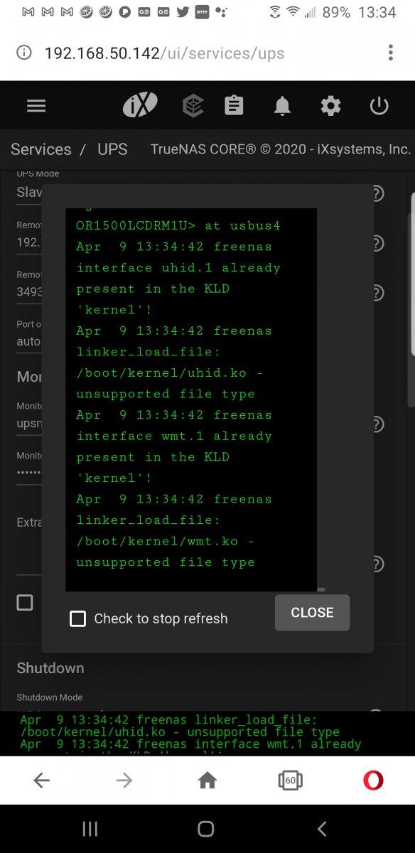

Frozenstiff
Jan 17, 2020
I'm having the same problem. My UPS is a CyberPower OR1500LCDRM1U. I read on a FreeBSD forum that you can disable the modules, but since this is a heavily modified version I didn't want to do that without advice first. I'm not sure why the system doesn't just ignore the modules if the drivers are already present in the kernel. Mine keeps attempting to connect then disconnecting with an error:
Let me know if anyone that can help needs more information or a screenshot that isn't from my phone, though there wasn't much else from the log.
Thanks in advance for any advice.

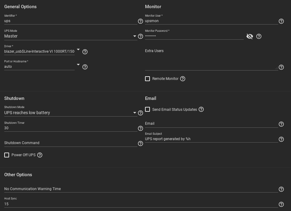

papalangi
Dec 26, 2017
15
Now I tested a little bit: in configure UPS I set the port from "/dev/ugen0.2" to "auto" and then it works again.
I don't know why. But still with 12.0 U3.1. I didn't test it with U4
