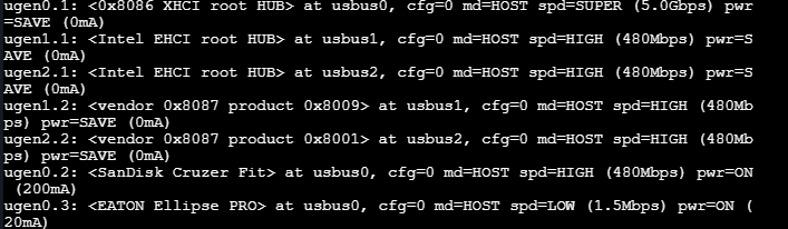

An usb config command returns:

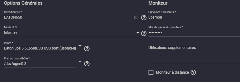

In Services
UPS is set automatic start with ugen0.3
Do you have any experience on this behavior ? What could be done to fix this ?
In Services
