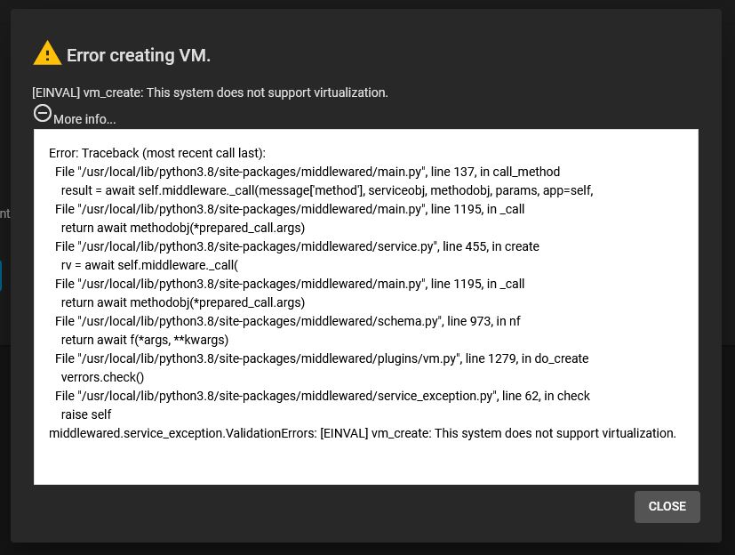

Hello, I can't manage to virtualize Ubuntu on TrueNAS. Could you please help me?

After doing a TrueNAS virtualization I get this error (image attached). And I'm not very good at doing this kind of thing, so can someone help me to solve this problem?

The last line of your screen capture is key: "vm_create: This system does not support virtualization."
So either your Gigabyte mother really doesn't support virtualization, or you need to change its BIOS settings to turn on virtualization support.

Thanks, but do you know what option I should look for approximately ?

The manual for the B450M DS3H shows virtualization is disabled by default in the BIOS. Look under M.I.T. -> Advanced CPU Core Settings. There may be a setting for SVM Mode, which is disabled by default. You'll need to enable it to turn on virtualization.
