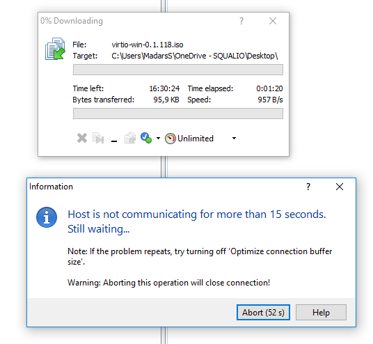

7. Open FreeNAS GUI - fail (continuously loads login page without success)
8. Open SMB share - success
9. Copy some files from SMB share - fail (hangs up on "0% complete")

Yesterday I tried to copy files using WinSCP because SSH (sort-off) works with cxgb0 interface. I started to copy some files and after few seconds it failed as well.

Then I started to look through /var/logs and found out, that if I tried to "cat" some bigger file connection would drop, but if I "cat'ed" some small file it would output information. I added some information from log files, that I was able to get when I tried to access Web GUI.
