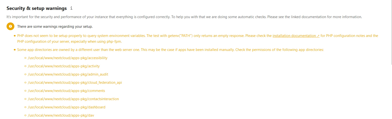

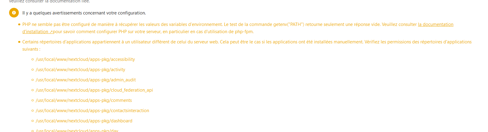

en allant verifier sur Nextcloud dans la Vue d'ensemble, j'ai cella :
Comment je pourrais résoudre ce problème, suite à la mise à jour mysql8.
Hi Don't speak French but from some keywords in your error I'd say you:
- do not have the environmental variable PATH set (See: https://forums.freebsd.org/threads/environmental-variable-in-a-jail.70120/)
- have a permissions issue with the listed folders ((Before doing this make sure you document what the current permission levels are!) As a test just do a chmod 777 for al these directories and see if that solves it. DO NOT LEAVE IT LIKE THAT!!!!! )
A tip, always keep your technical language set to english (so when coding, reading logging) this will make finding solutions and getting help much easier.
nemesis1782
Mar 2, 2021
105
Ah ok, thnx. in that case for the first see the documentation (referred to by the link in the error) and configure your webserver properly. It's missing some env vars (I think my previous link still holds true though).
Ok for the other one it says that the owner is different from the webservers user. So findout what user the webserver is running under and change the owner for these folders. This way you can keep the permissions clean.
