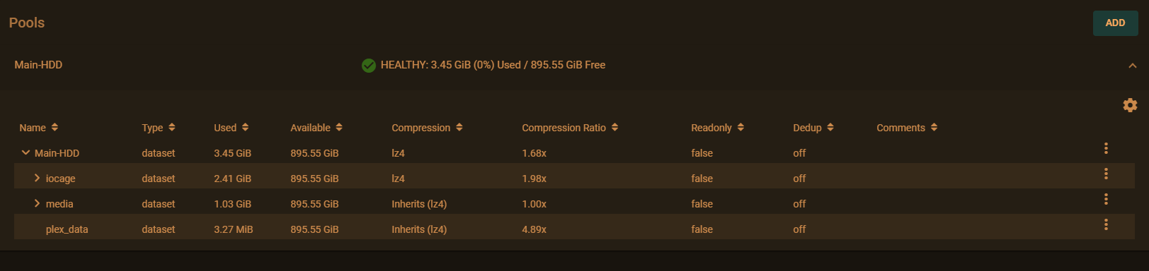

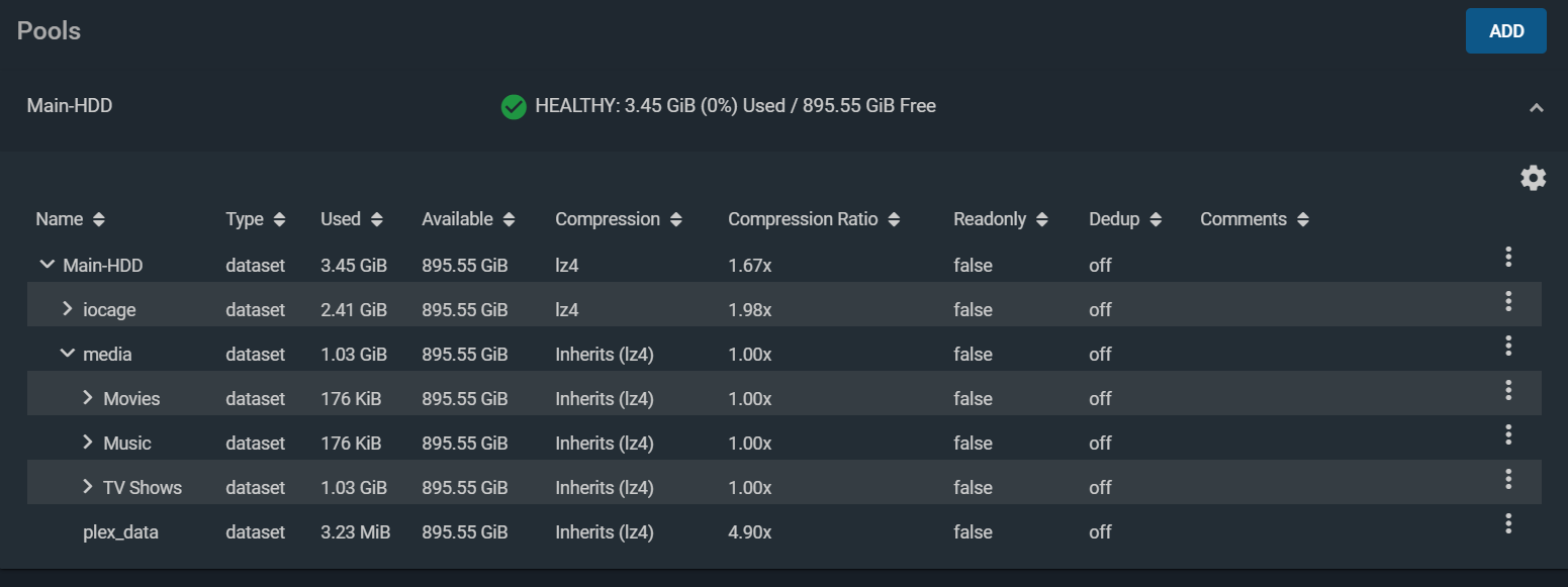

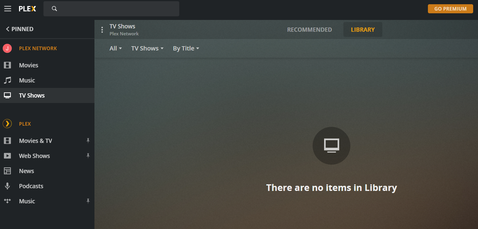

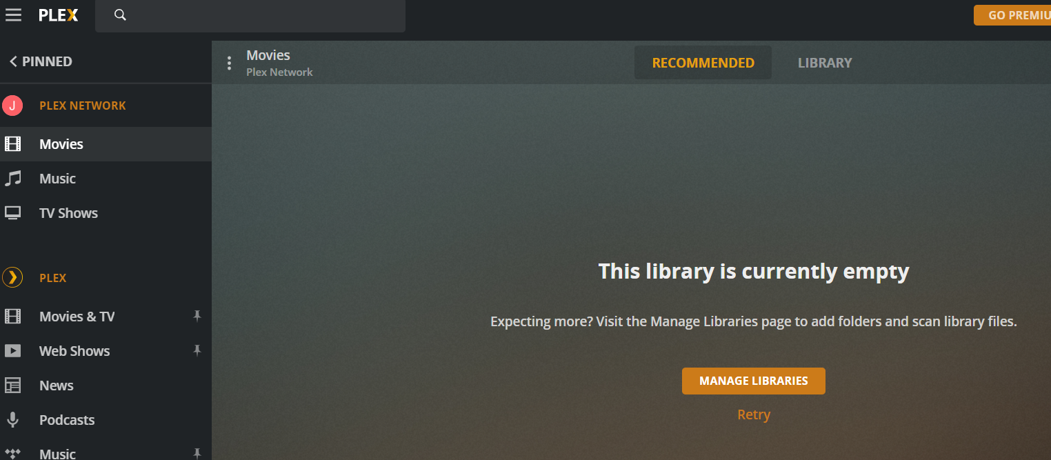

Hi all,
I think the permissions are wrong or something... Plex is unable to see the items in the Media\Movies & \TV Shows and \Music Folders.
There is nothing in this folder, but there is in the TV Shows folder & it's like it can detect it but can't see/show it...
Following what @Yorick said, 'You are right that this is likely a permissions issue. You can try and set up a Media share with "pristine" permissions, then compare to yours and see where they differ. I have a video that discusses basic permissions, including for Plex, at https://youtu.be/9Xsgsap0wgQ'

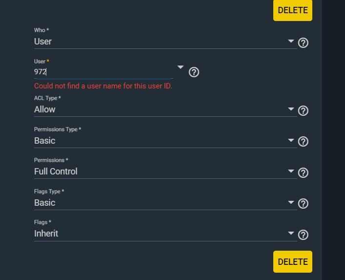

Unfortunately, i get this error message saying '972 - Could not find a user name for this user ID' as of below screenshot.

Of course. The user doesn’t exist in the OS, just inside the jail. Just hit Save, and mount that dataset into Plex, create some movies and Tv shows and music folders in there, see how it behaves.

This is how I've got it set out like. Movies, Music, TV Shows datasets have the same permissions as the Media folder.
What do i need to do?

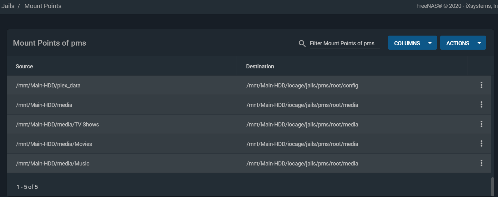

Oooh is this what you mean? I just added my TV Shows, Movies and Music Folders and mounted them. Stopped and Started the Jail but still not showing...

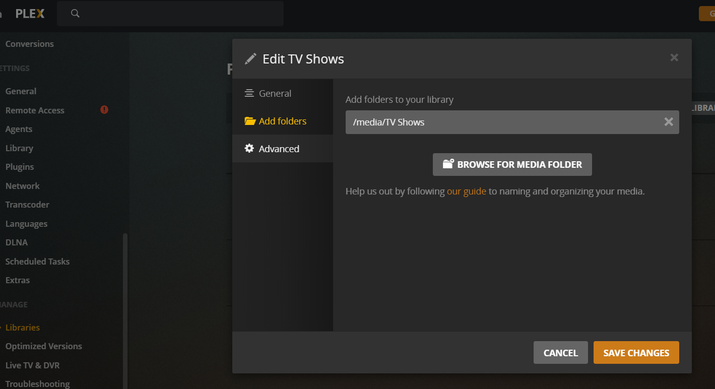

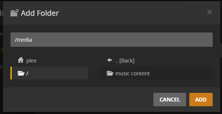

If your first picture of the Plex folder your are trying to use it's /media/TV Shows but you are mounting things in your jail as /media.
Fix your locations so they actually exist.

Yorick
Nov 4, 2018
1,912

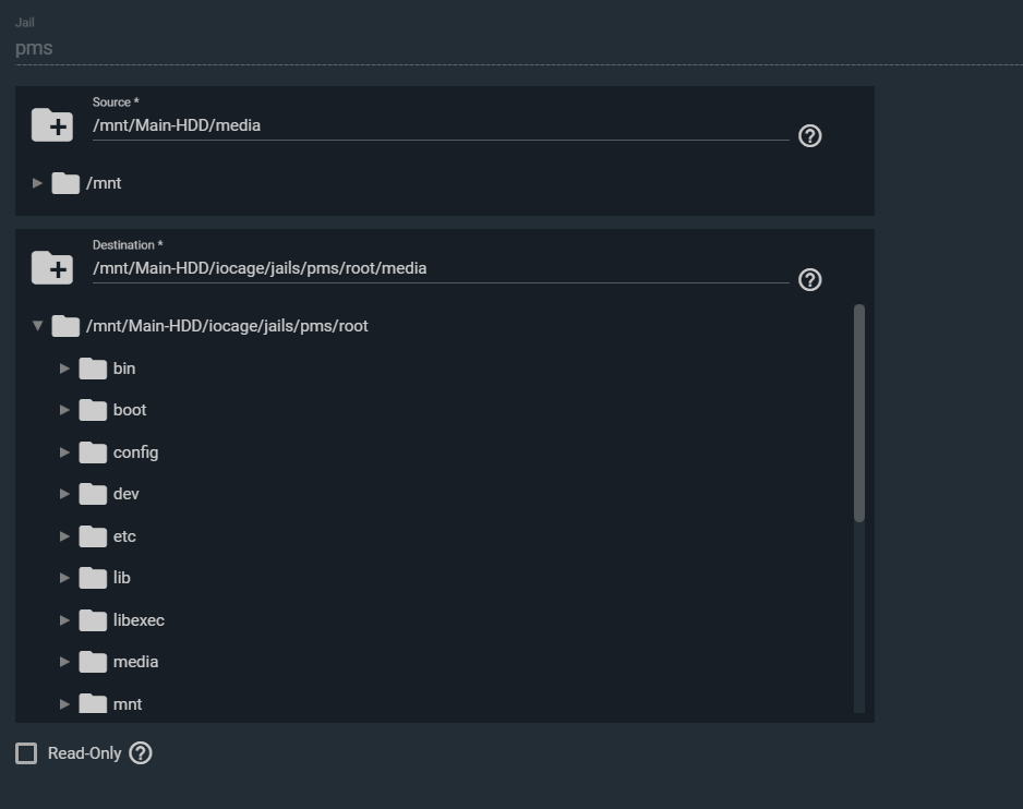

You are mounting 4 datasets into one location - that won't work.
The easiest way to do this, if you don't need separate datasets, is to get rid of the three separate datasets, and just create folders in the top level dataset called 'media'. The easiest way to create folders is to share the dataset out via SMB.
I see a steep learning curve ahead of you :).
Yorick
Nov 4, 2018
1,912
plex_data is your metadata. See my earlier comment - have one dataset called media, no datasets under it. Mount that to root/media in Plex, create folders in it for Movies etc. As long as permissions are right that'll have you sorted.

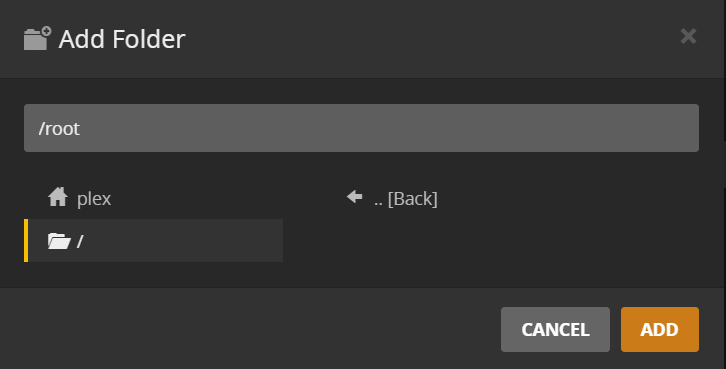

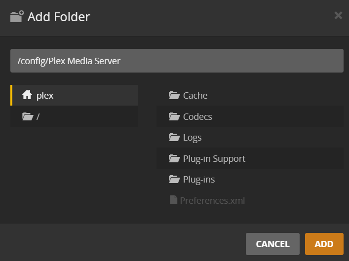

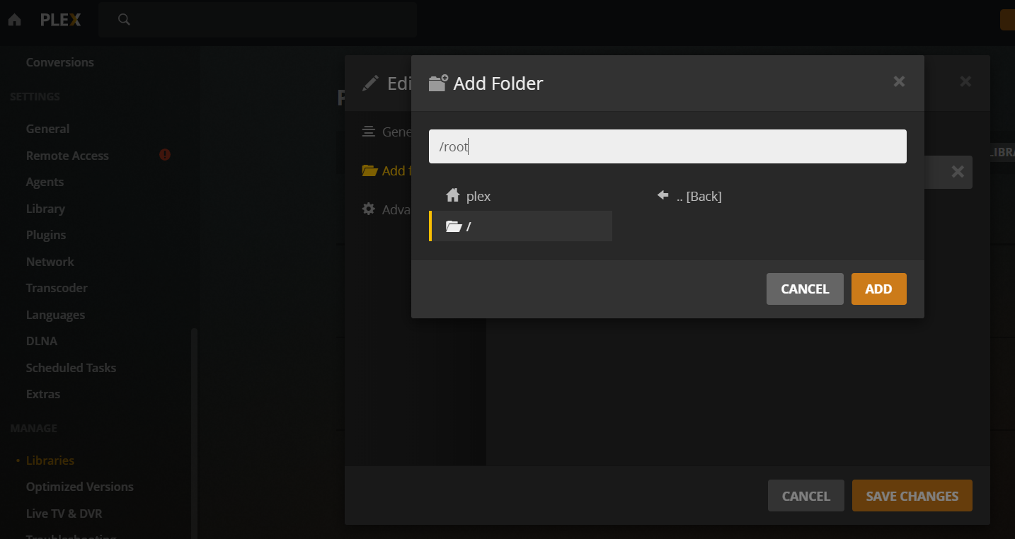

I see what you're saying now, but when i try and mount it to the /root/Media. It cannot see the media folder(s)
SweetAndLow
Sweet'NASty
Nov 6, 2013
6,421
/root is not part of the destination path. In the Plex ui you need to double click "/" then there should be a media folder you can use.
You also have so many other problems. You need to just play around with things until you learn how it works.

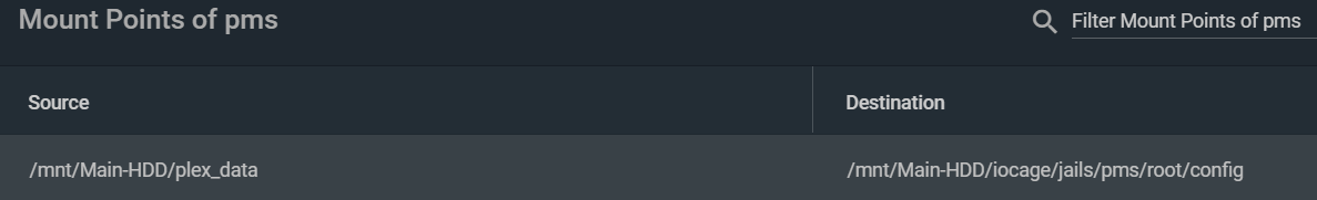

1. Your plex_data source for your jail mount point is wrong.
2. You are mounting the media dateset and child folders.... Why? Just mount the media dateset, nothing else.
3. Everything is being mounted to the same destination, you can't do this.
4. You keep navigating the wrong paths.
5. We haven't even gotten close to anything permissions related, you are probably weeks if not months away from getting this to work.
It was here in the first place but got told that's wrong.
Well i followed the Youtube video that @Yorick mounts this 'plex_data'...
Following the Plex 'Naming and Organizing your movie media folders' - https://support.plex.tv/articles/naming-and-organizing-your-movie-media-files/ so it find the content without an issue.
3. Everything is being mounted to the same destination, you can't do this. - it's not, it's being mounted to the folders within the Media folder so Plex can read each folder?...
4. You keep navigating the wrong paths. - ?
5. We haven't even gotten close to anything permissions related, you are probably weeks if not months away from getting this to work. - I've done the permissions watching another of @Yorick video's which was suggested.

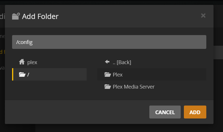

Jord9857
Apr 28, 2020
74

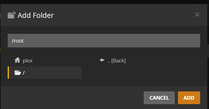

So Plex cannot see the Media folder from here.
From this Mount point i set up, it suggest 'root/config'. Although when i go to either of these nothing is there...
SweetAndLow
Sweet'NASty
Nov 6, 2013
6,421
It's just /config
