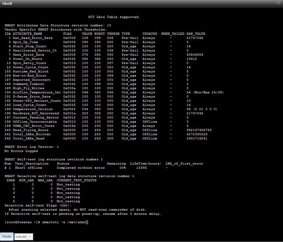

Heres from the command you listed.
Edit: had to upload a photo, output looked fine when pasted in but was completely messed up after posting

ECC RAM has nothing to do with this type of problem otherwise I would have mentioned it, although having ECC RAM is a very good thing when dealing with ZFS. Lack of ECC RAM could result in data corruption during a scrub, not drives going offline or having chksum errors. Also, running a scrub does no harm providing your RAM is fine but that is the risk you take not using ECC RAM, again, it's not a RAM issue for this thread.
Don't let all those high values in that smart report concern you too much, they can be that high under normal conditions for many drives. If you have values in ID's 5, 196, or 197 then you are looking at a hard drive failure. I would replace the SATA cable first (I prefer locking cables). If you have another open SATA port you could plug it in there as well in case it's your MB connector.
