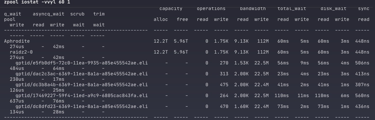

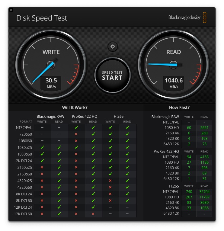

I am using 13.0-U6.1 and am having extremely poor SMB write performance.
Pool is 63% used.
zpool status pool: Aphrodite state: ONLINE scan: scrub repaired 0B in 19:42:46 with 0 errors on Sun Mar 10 20:42:51 2024 config: NAME STATE READ WRITE CKSUM Aphrodite ONLINE 0 0 0 raidz2-0 ONLINE 0 0 0 gptid/e5fb0df5-72c0-11ea-9935-a85e455542ae.eli ONLINE 0 0 0 gptid/dac2c3ac-6369-11ea-8a1a-a85e455542ae.eli ONLINE 0 0 0 gptid/dc3b8a4b-6369-11ea-8a1a-a85e455542ae.eli ONLINE 0 0 0 gptid/17469227-59f4-11ed-a9c9-6805cac843fa.eli ONLINE 0 0 0 gptid/dc8dfd23-6369-11ea-8a1a-a85e455542ae.eli ONLINE 0 0 0 errors: No known data errors

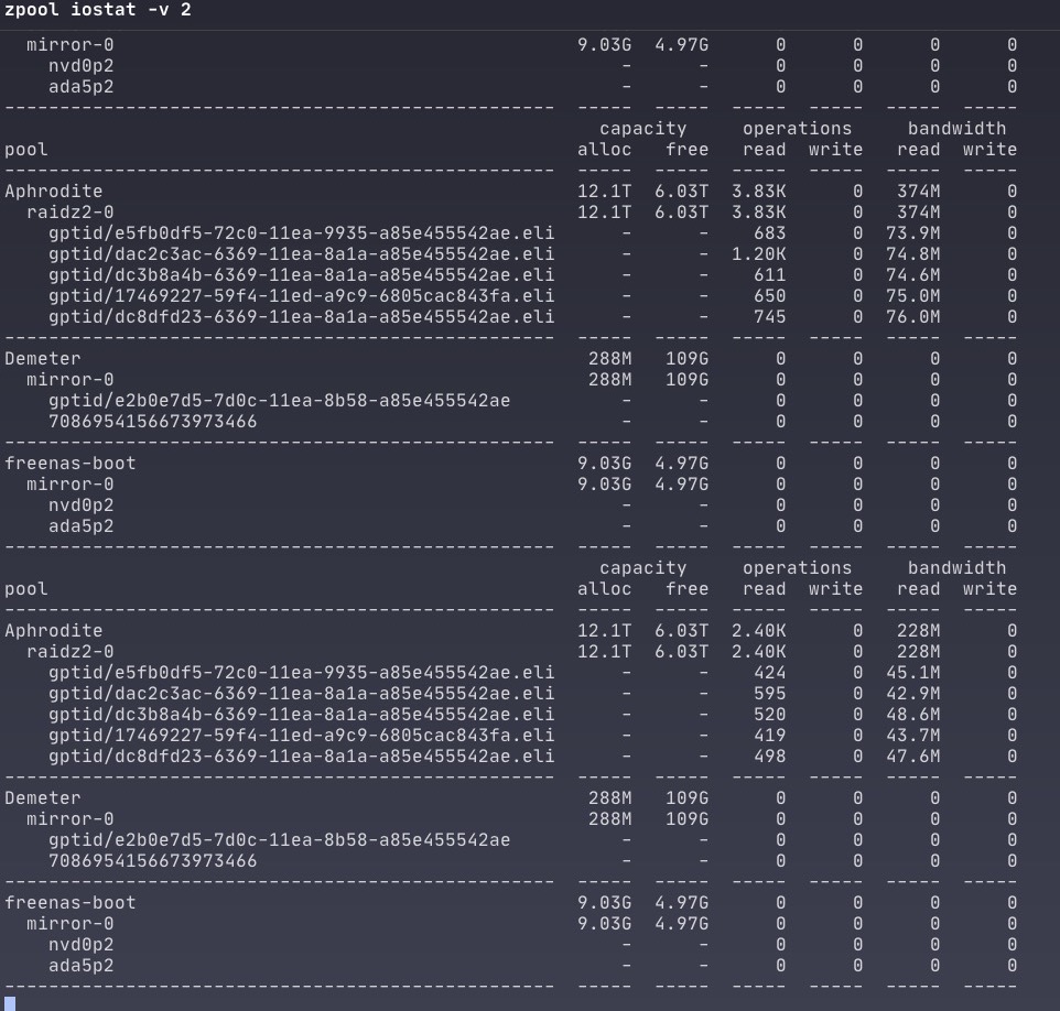

You can check if you go to settings -> shell and type "zpool iostat -v 2" while running your benchmark. If you see little to no read operations on the pool then the data is read from RAM which is orders of magnitude faster than your network.

Zeff
Mar 13, 2020
19
zpool iostat -v 2:
This was reading a 5.5GB iso file:

I just ran a test on a locally connected (USB 3.1 gen 2) IronWolf of the same model, using Blackmagic.
This connection is 10Gbps, and my network is 10G.
Writes: 152 MB/s
My TrueNAS using a RAIDZ2 is 5 times slower.
